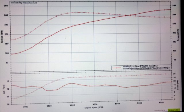

Please share your build as soon as it kicks off. I am sitting with the same issue where I am unsure of turbo choice. G25 550 was 1st on my list, since I have tried the GT2563R route, but was not impressed by what it made in the on like 2bar of boost(28/29PSI). Barely made 300WHP on that with all supporting mods
What I have seen is that the G25 550 comes on full boost (28/29PSI) around 4400rpm from the builds on youtube. This is about 1500rpm less than what I am doing with a GTX2563R, so I can only imagine it being good
2,206
2,644
Burlington, NC, USA
#20
My GTX2860 makes full boost around 4500. The G25-550 is much sooner, below 4000. Pic below of @xxiaze G25-550 vdyno for reference
