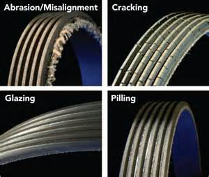

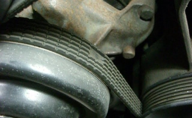

Timing belt in previous car would start stripping teeth. So an occasional inspection would catch that. I've replaced three timing belts just based on that; before it caused a problem.
With any serpentine belt, they typically start squealing, particularly on cold starts. This is a sign of wear; either of the belt or something it's driving or both.
Baring circumstance to cause premature failure, (such as bad bearings on a compressor pulley,) you typically hear them well before catastrophic failure.
I will add that belt laid flat, there needs to be gaps with the cracking. Even relatively new belts show cracks. Any cracks on the base of the belt (between the ribs) and it should be closely monitored if not replaced. Brittle/flaky material and it's past it's prime.
Among serpentine belts, Gatorback has a unique design. In addition to the aforementioned, this is what you look for. GB also has raised leading edge. I can see that's completely gone here.
