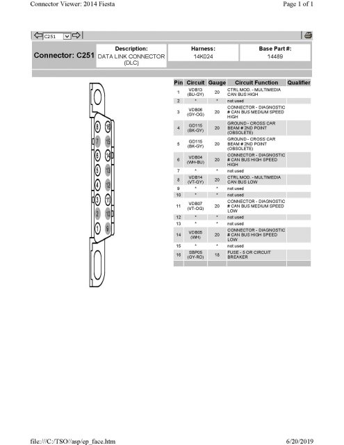

There is NO tach pulse at the ALDL connector.
The AP uses the CAN buss to get all the information.

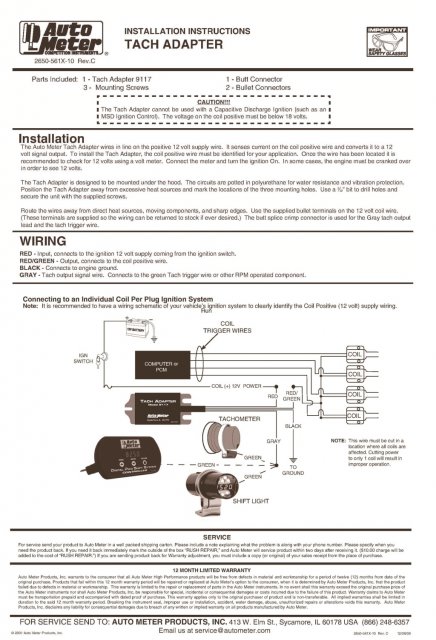

You should be able to use that light however, because of Ford's multi spark and coil over plug you will need to use a tach adaptor.
I already went through this when I installed my AutoMeter shift light.

Awesome! I just ordered the same Tach Adapter. Do you recall exactly which wire you tapped in the harness behind the left headlight? Do you have a closeup photo of it by chance? Thanks a million!
What year is your car?
My shop manual is for '14 so yours may be different.
D1JL
7000 Post Club
#1011
7,928
4,190
#19
This is a very important connection.
Do you know and have tools to solder?
Here is the AutoMeter instruction.
