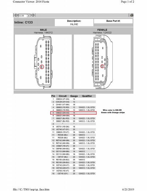

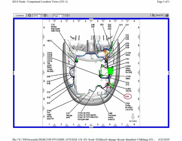

Locate connector C133
Here is the connector view
Locate pin #5 on the chassis side of the connector.
The wire color is Green with Orange stripe.
Here is the wiring diagram view
You will cut the Green with Orange stripe wire (Pin #5) on the chassis side of the connector.
Make sure you are far enough away from the connector and have enough wire to work with.
Use heat shrink tubing for insolation, connect as per the AutoMeter diagram provided.
You MUST solder these connections.

Thanks a million man!! This is extremely helpful.
