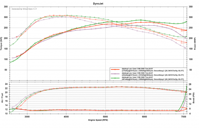

Tune is progressing well - some decent graphs which are corrected to ambient conditions best I can do - the numbers seem to be around 275 whp and 305 lb*ft. I've just submitted some more logs and am anxiously waiting the change to race gas. I'm curious to see what sort of performance bump I can get when adding it to 94 octane.
