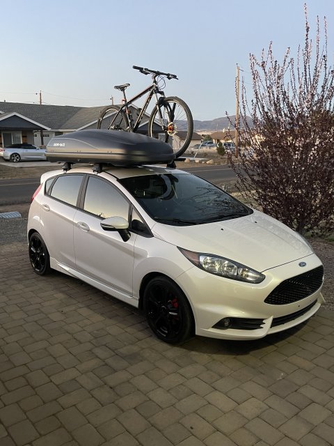

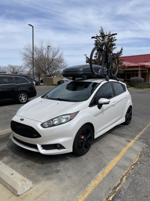

After all the agonizing the over-analyzing, we decided to start with a roof rack setup. Ordered some Rhino cross bars from etrailer and will be mounting up some 1Up roof trays. The nice thing about the 1Up roof trays is that they can be converted to a hitch rack down the line by purchasing a couple extra parts. Love the durability and modularity of this system.
The hitch-mounted 1Up rack was pretty mangled from our rear-end accident in the Subaru, but I managed to move some parts around and salvage a single tray hitch rack that is more or less good to go (couple parts are slightly tweaked, but ehhh....).
