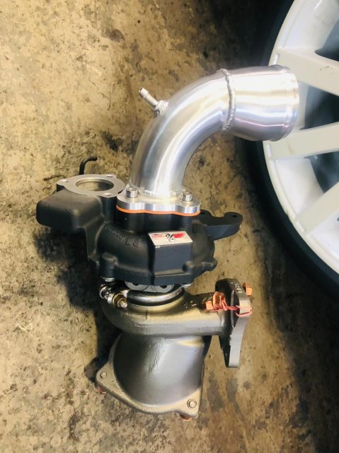

Hybrid is in
Software loaded
Cad is feeling like another beast. It’s demonic. The spool. The flutter. The burble. It’s perfect. It’s monstrous. I’m flabbergasted. Definitely need to install my EBC yellow stuff though, stock brakes aren’t cutting it.

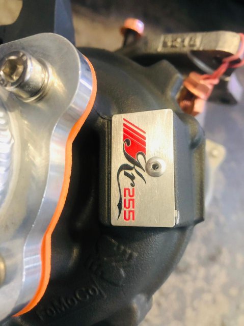

Not alot of info on that turbo. Never heard of them before. Do you have any specs on it?
https://www.karter.co.za/product/ford-fiesta-st180-200-kr255-hybrid-turbocharger/
The yellow stuff brakes a good, but doesn't have the initial bite the OE pads have. But they, from my experience build up more than OE.
Yeah, they haven’t released specs due to the risk of competition copying them. A lot of local places buy the X47/X47R and then copy it at turbo reconditioning places or engineers. So I do not have any info on the technicals of the turbo.

So the turbo is in, software loaded etc etc.
Car is boosting 1.9 bar when it’s meant to boost 1.7, the actuator was preloaded too much so need to loosen it.
Car has 1 or 2 miss fires at the top end of 3rd and 4th.
Car also has engine light due to code P0039 and I think it also threw P0017.
I’m gonna loosen the actuator this weekend and throw in new plugs. Timing belt was done a little over a year ago so can’t be the belt. Any experience here? What could be the cause?

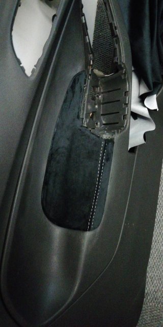

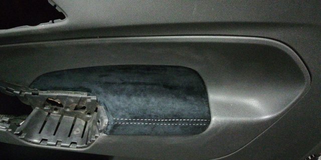

Alcantara interior is finally being done, fully sponsored. Change to the rear diffuser. Stage 3 cooler looks so boss behind the grill delete

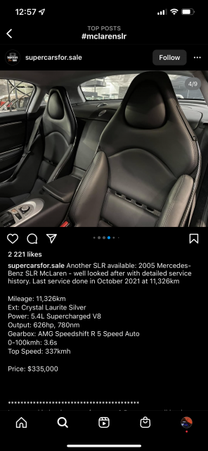

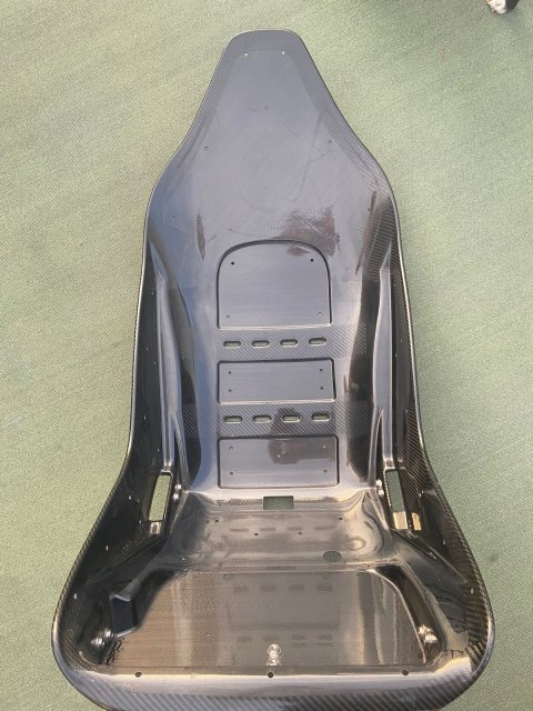

Mercedes Mclaren SLR carbon fiber bucket seat will
Hopefully be going in next week. Picking up a set of what I believe to be sparco sliders that will Hopefully fit the seat and the car. Then it’s off to be upholstered. Can’t believe I got a genuine mclaren carbon bucket seat. Mind blowing. Paid 1500ZAR for , what’s that like 90$USD? Has genuine part number and the likes

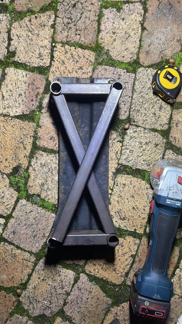

Bought sheet metal (1.5mm thick 610mmx1220mm x2 sheets) to build a “flat floor”/skid plate/underside engine cover/tray what have you.
Fabricated my own torque gusset and front trac bar combo based off of TB performances website as well as the rear axle torsion bar and center I brace. Just need to make stop strut for the engine bay and the cross member brace then it’s onto experimenting making my own rear camber plates. With the South African currency, exchange rate, customs and shipping it simply isn’t worth importing. So that’s suspension done.
