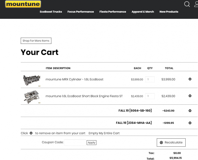

It is very possible. I'm actually thinking I only messed up the valves. But, I never ever ever want this to happen again. I'm on pumaspeed right now getting some ideas. Forum, you have my checkbook give me your thoughts.
I'm giving you 5-7k go. I'll list current mods again. Whoosh v3 intercooler, 2jr intake and downpipe and side exit exhaust, turbosmart wastegate actuator, turbosmart bov, symposer delete, cobb RMM.

Either which way you look at it, it's better then spending 5 grand on a new one from Ford with nothing but oem on it. I think I'm gonna go with the red with the x47 turbo. It'll set me up nicely for 320+ up and be more bullet proof. Plus with the lower wastegate I won't have an over boost issue again
