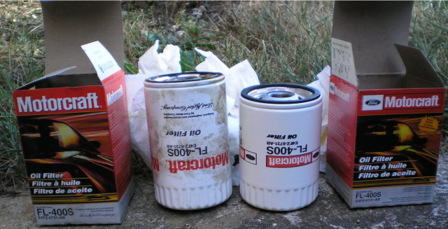

............... AFAIK the biggest oil filter you can run with the Mountune is the FL400s FoST filter.
Ran those on my 1994 vehicle. That was a SOHC 1.9L 88HP engine. 🙂 At some point, maybe a decade ago, they downsized it. Probably still bigger than the can in that cramped space between oil cooler and radiator though.
