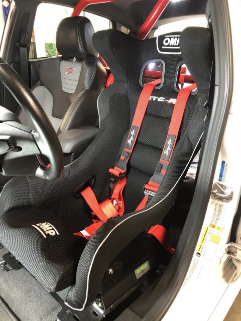

Followed some of the advice on the OP’s post. I bought the same resistors on Amazon. Instead of using wire and vampire clips, I just shoved each end into the airbag sensor connector and taped it securely. I also removed the seat rail sensor from the bracket and tied everything up neatly under my OMP seat. Worked perfectly and didn’t take long at all.

Which OMP seat did you install? I'm looking for the largest seats that will fit, seems like the shoulders/b-pillar is the main issue.

Cool thanks for the photo! Looks like you can't get much larger than that so I'll use that model as a frame of reference.

Yeah it’s the widest halo you can use without removing the seatbelt and trim. I update the post above.

Looks super tight in the hips but maybe it's just the angle mixed with the style of seat. I'm not opposed to a halo but wide fixed back was my priority. Thanks again.
