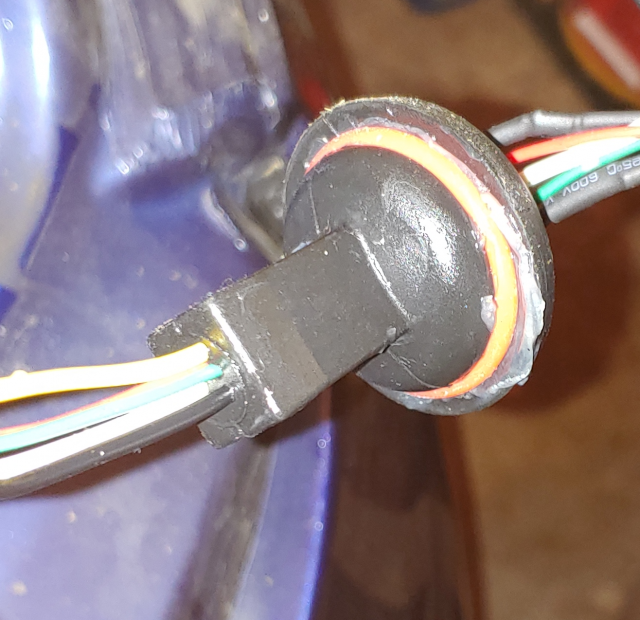

* The Spec-D grommets don't really fit the Fiesta; can leak. Compensate by adding a silicon o-ring (see photo).
I used 25.7x3.5 (R-20) from this kit. https://www.amazon.com/gp/product/B08FD1QQCT/ Just press the grommet in and it'll be firmly locked into place. The white stuff is silicon paste. https://www.amazon.com/gp/product/B077PD43P8/

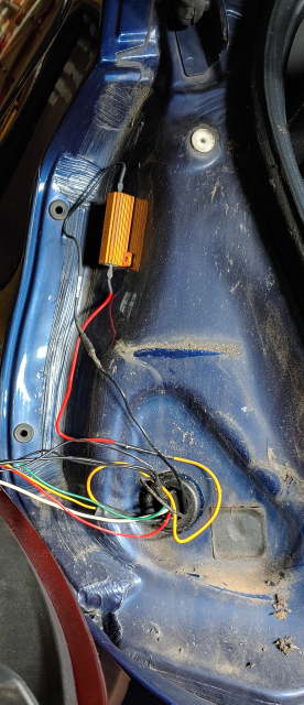

* Put your resistor behind the light, top quadrant, side of the vehicle. (see photo)
