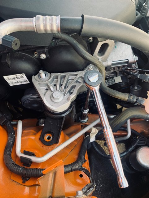

I should add like others have said the Powerflex passenger side engine mount insert is a very economical why to really stffen up the engine mounts with minimal vibration ( still breaking in) and upside is it does practically eliminate Torque steer and you can hook up much more linear fashion with just straight pull. I think if I threw in a LSD I would be in heaven. ;)(y):love:
It also helped eliminate a lot of the stock tire tramlining down crowned and bus rutted roads.

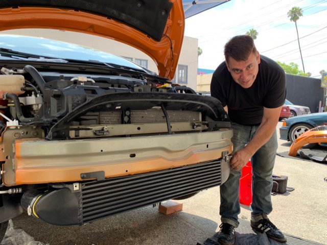

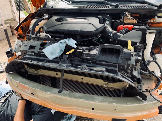

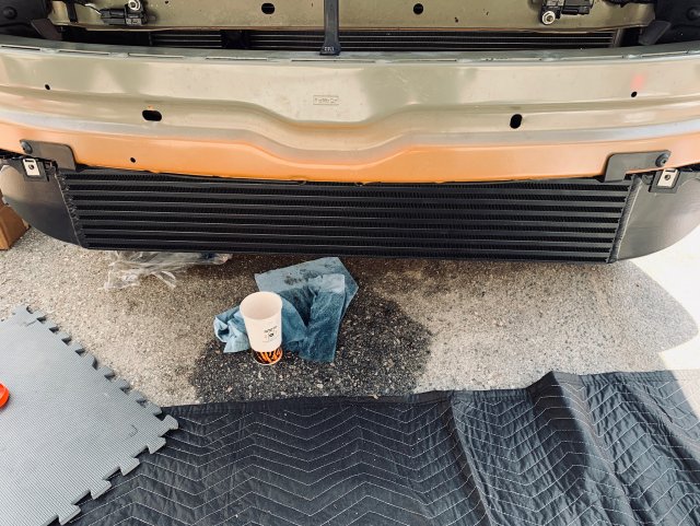

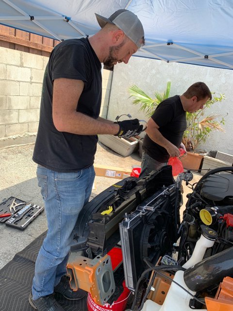

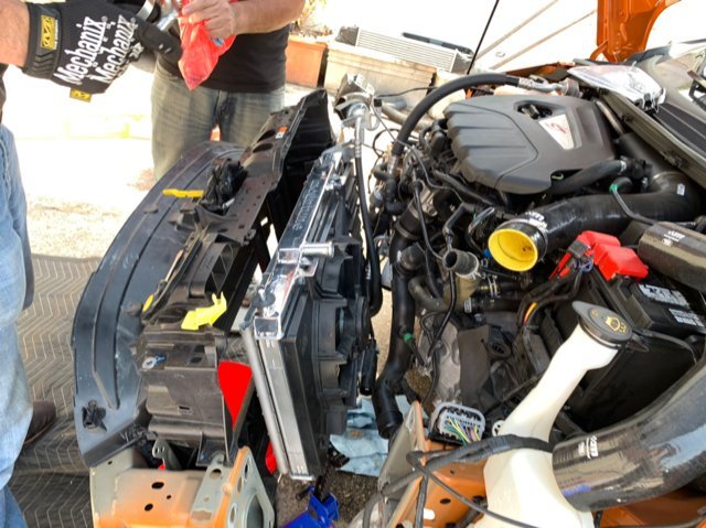

Oh and I give props to Koozy and Booster for helping out and thanks to Koozy for suggesting pulling the crash beam rather than trying to put stuff in from underneath. It actually made the radiator install a breeze as we were able to put the fan shroud on the radiator outside of the car and just drop the assembly in and remount.
It worked out well that way as with no lift pulling it out from underneath can be annoying plus we were doing the intercooler as well so damn why not.

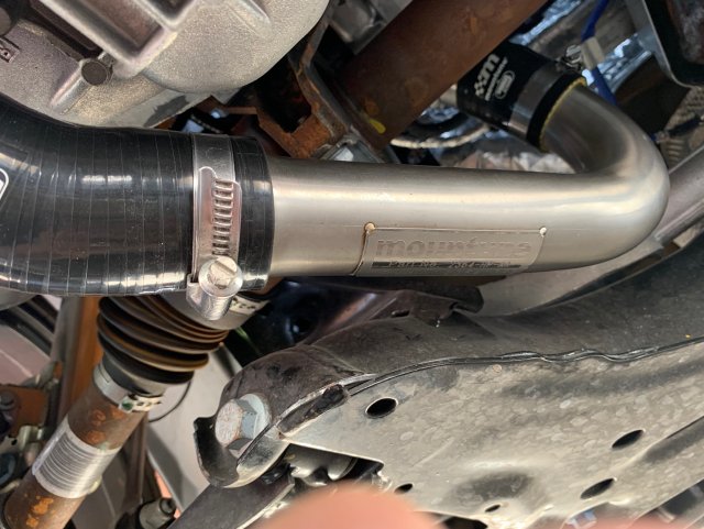

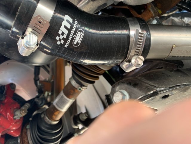

The Pro Alloy stuff is sick. There intercooler and crashbar are awesome. If you are going aftermarket crashbar in my opinion there is no better. I am not sure you can buy it without their intercooler.
There radiators are really nice as well.
I am happy with the Mountune though. My temps are down a good 10 degrees. Thats cool you can go see Jason in person. I am probably going to get some of his tunes on the next sale.
