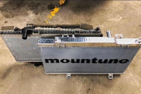

Hello! So i bought an ST a little over 4 months ago, iv been loving it. A couple months ago i did some sort of spirited driving uphill and the car overheated, threw a warning light, so i waited for the car to cool off, it leaked some fluid but that was it. i turned the car on and waited to see look for a leak but there was none to be found. fans worked everything seemed okay so i drove back home (2 hour drive) and everything was working normally. i couldnt live knowing the car could overheat when pushed so i upgraded the intercooler to a mountune and switched the thermostat for a 180 out of motorcraft. this was maybe 2 months ago. the car has been performing perfectly, iv been pushing it within city limits and its never over the desired temp. the coolant level was a bit under the minimum level, i didnt top it off but i kept my eyes on it everysingle day and it stays in the same spot. so last week i decided i felt comfortable with topping the level knowing it was leak free. today i checked the level and it was back at under the minimum level again, same spot as before. car is working perfectly, it doesnt go under that level. do you guys have any input in this? i am going to top it off again today after work but i dont know if its a normal fiesta thing or what. The car has no power loss, no leaks, its working at perfect temps (i keep an eye on them with an obd2), it just levels under minimum and stays there.

First, you replaced the radiator, not the intercooler. The radiator is what cools the Engine, the intercooler cools the intake charge.
Your overheating was caused by the factory choosing to use a radiator that has proven to be marginal in high heat situations and by replacing that radiator with one that has a larger cooling capacity you have solved that issue.
BTW, not a fan of changing the thermostat to a cooler one, with these engines that can result in some negative effects on some of the performance aspects. One will likely be a reduction in fuel economy. There is also the fact that doing this is probably a violation of the EPA regulations.
To sum it up your new radiator was the solution for a problem that is well known in the FiST community. The only other issue that you can expect to crop up is a failure of the motor for the Blend Door actuator, from what I've read those generally fail around 30,000 miles. BTW, there are two of these blend door actuators and one is easy to get at behind the cabin air filter. The other is a PITA and when it goes on my car I plan on cutting an access port into the under dash panel to make this area easier to service.
Seems to me a bit of a waste to give up on a great little car just because of a few minor issues. Especially after you've already fixed the major issue.
