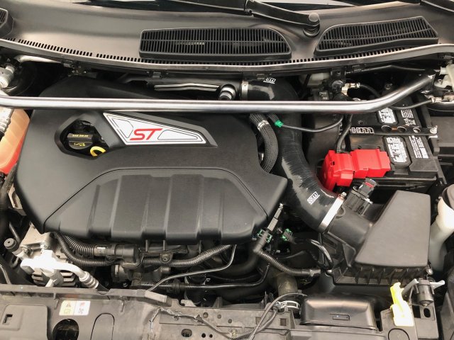

Am I seeing things, or does the Mountune airbox not have a HUGE intake hole that the ST200 does not?
https://cdn3.volusion.com/rnmwa.rjxsk/v/vspfiles/photos/2364-CAIS-AA-2.jpg?v-cache=1394710558
Since the Mountune unit re-uses the upper half of the stock airbox, it seems equally "stealthy" to me. I understand the concerns about aluminum vs plastic, but doesn't that larger intake hole more than compensate for that?

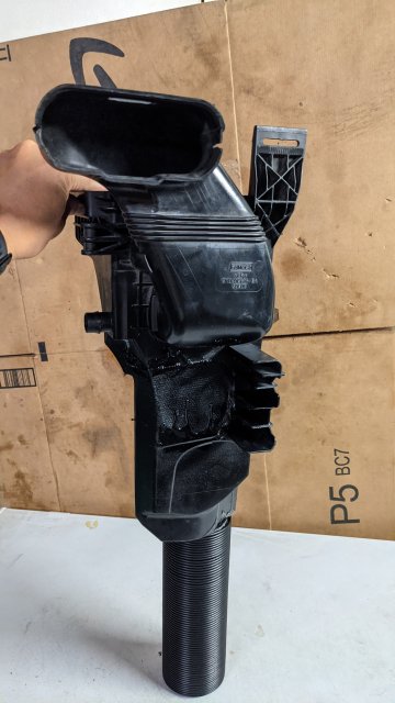

This is the video I made on the ST200 airbox. The ST200 airbox would be easier to install. You don't have to remove the OEM front snorkel like you have to on the Mountune. That big hole you are seeing on the front is where the OEM snorkel connects to. The ST200 air box comes with that already attached.
View: https://youtu.be/DHgMcEiqhug
D'oh! didn't realize that the snorkel inlet was that big! Thanks!

If you have time with the st200 you can buy a flexible hose off eBay and route it to the foglight on the drivers side. That's how I have it run.

I like the Mountune box and have used it. The ST200 box listed on my site now is more than $50 less than Mountune, is 100% stock looking compared to Mountune, is plastic vs. aluminum which won't heat up like an oven.
Best of all there is no "hacking" compared to Post #1. Some people enjoy DIY work on their cars, others like factory fit parts. The ST200 box will fit like your OEM box does.
I don't live in Vegas, but heat soak is not a big deal with either. If it's hot enough, and you're not moving enough, you'll get heat soak, even if you wrap it in gold.
Not only does the ST200 box cost less and look stock, it IS stock. And it comes with a brand new snorkel and a stock filter.
You have to take the snorkel out of the stock box and install it in the mountune box, and it's a bit of a PITA. It's already there on the ST200.

The ST200/mountune airbox was developed for rally racing. It's a great design.
It uses the front intake, along with a true CAI through the porous hose that goes into the space under the fog light.
If you drive through some creek-deep water, as rally racers sometimes do, the porous hose will not let water get drawn up into the intake, since the front is also drawing in air.
The best real world CAI design, but some people want more whooshy intake sounds, and that's OK, too.
