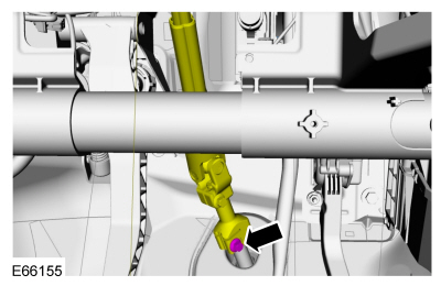

As you can read along this hilarious thread, I was very certain that it was the bolts at the steering gear knuckle. So I went to the dealer.
Service advisors couldn't feel anything at a stop or at low speed, so they took the car back to a lift and came back soon. Finding nothing loose under the chassis at the suspension, they concluded (as they did earlier on the phone) that this is the same issue with the Fusions, and quoted me 600 and 2 weeks for a new gear assembly and labor.
The master tech, wanted a look himself and invited me back. He compared another Fiesta on the lot and found that there was a difference in feel when slightly turning the steering wheel back and forth at a stop. He ended up pulling the boot, and after taking a torque wrench to it found that the bolt from the shaft to the gear was loose introducing play.
New bolt, some threadlock and I haven't had an issue since.
I bet others also have this loose bolt, but they may not feel it until it becomes super apparent with higher mileage/use. Anyone can do this at home with the right tool before it poses a larger issue.
Parts Diagram:
https://parts.ford.com/shop/en/us/steering/steering-parts-other/column-assy-steering-7869729-1
Bolt HB-2:
https://parts.ford.com/shop/en/us/bolt-7828037-1#sectionId:4228132
Pink bolt below. Torque to 34nm. Per Ford Service manual, "Reuse [of bolt] could result in bolt failure and loss of vehicle control."
