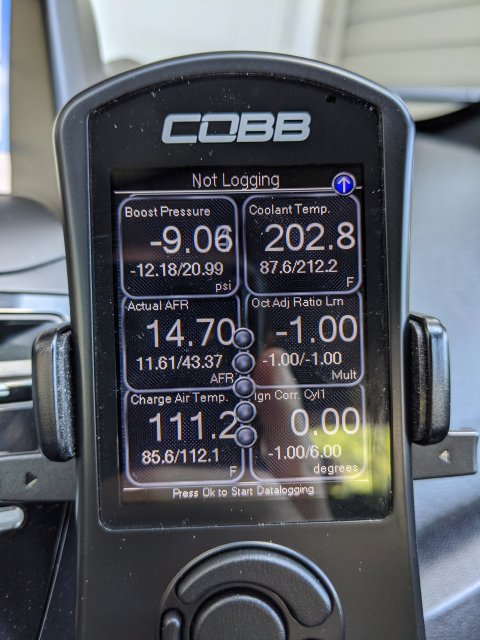

Ambient at about 90 F, seeing 95 F ambient on the dash. All stock other than the Cobb OTS stage 1 tune. Did a short stint on the highway at ~70 mph (mostly as a drone test for the Thermal R&D CBE), and then some stop and go in suburban 45 mph limit roads.
I was not beating on it, and I would definitely be asking for trouble if I was. The little bit of negative correction I'm chalking up to it just being really bloody hot in NoVA today. This is the hottest day so far this Summer, and I really need to get that intercooler replaced.
I thought it was a fair critique that my first picture was while I was driving. Here's one after idling for 10 minutes in my driveway after a 40 minute drive in above 100* full sun weather.
I revved the car a few times and got it to creep towards 200*, but got bored and went inside.
I've seen it hit above 200* but it doesn't take much to bring it back down.

I'm honestly impressed that it's holding that steady with charge air temps in the 130's. The peak of 212 on the coolant I got came after a longer uphill start. Going uphill in boost was how I nearly overheated my '15, so none of this is all that surprising to me. So far no genuine issues with the '16, but I'm definitely taking it easy until it starts cooling off again.
Keep in mind that the cooling system is self pressurizing and as pressure increases, so too does the boiling point of water. Considering what temps your cylinders hit, seeing coolant temps above the boiling point of water at STP isn’t really unusual.
