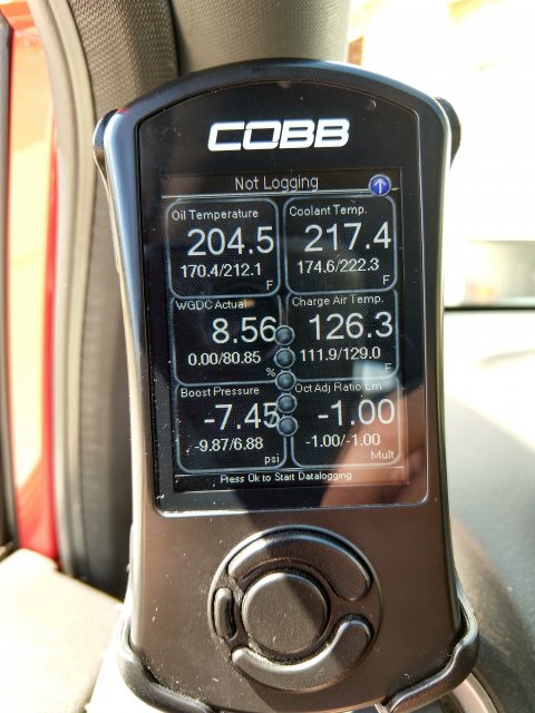

About 98-100 degrees out my temps are about 194-195 at idle with the A/C on. That’s with CPE intercooler. I noticed temps we’re slight lower before I put the intercooler on, prob cause it’s so thic it block some airflow lol. I’m going to put some foam to seal the shroud and see if the temps change. But can’t say it enough I’m very happy with the mountune radiator, easily the best $500 you can spend on this car.

Even with 98 degrees outside with a/c mine never went to 217. Maybe 205-210 but not that high.

Seems high to me, I've been above 100 and my coolant temps rarely go over 200*.
