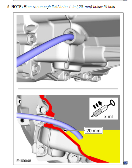

I can understand your confusion. The part of the documentaion that you missed, states to fill to 20mm below fill hole. In our observations, measurements and experiences, this isn't even close to 1.67L.
To make it simple:
FACT 1: Manual states 1.67L capacity.
FACT 2: Manual states fill to 20mm below fill hole.
FACT 3: It takes ~2.1L to reach, 20mm below the fill hole.
FACT 4: The car is level.
This isn't really a debate. I have a 2016. These are the facts for my vehicle. Others have had the same experience.

Safety related are not TSB's. Technical Service Bulletins is maintenance related and issued by Ford. Safety is issued through the feds, NHTSA. I can find no method of measurement for the 20mm, where did you find it in the manual? I must be missing it or just plain lost....... LOL!

The 20mm is the service manual. Doesn't really say where to measure from really which could explain why some people might not see the right level when they do have 1.7L in there.

True. Keep in mind: The fact remains that auto manufacturers do not always correct their mistakes. Saying that facts aren't facts simply because Ford didn't issue a correction to their documentation doesn't mean that facts cease being facts.
I can find no method of measurement for the 20mm, where did you find it in the manual? I must be missing it or just plain lost....... LOL! Could it be the 20mm is what is incorrect? Ford Engineering confirmed 1.67L in the manual is correct and Magna PT confirmed to follow manual that says 1.67L. I wonder if anyone has asked Ford if the 20mm is correct?
Once again, following the manual's documentation for fill, doesn't put you anywhere close the capacity specification.
@SteveS - 5.4mm is pretty close... just 1.24%. Yet we're talking about a nearly 20% difference between one part of the documentation, versus another.
EDIT:
It says 1 in. or 20 mm. Those are not equal. 1 in. is 25.4 mm. That might get you down to 1.67 l of fluid...
CORRECTION:
20mm / 25.4mm = 0.787 or 21% increase
1.67L / 2.1L = 0.795 or or 21% increase
@SteveS is on to something. :)
Thanks for the info. The diagram could be interpreted several ways........it also shows the fill hole as angled. And the hose as curved. Does not look like you can get any accurate measurements without a dipstick made for the correct placement with the hole on the correct angle. There is a .213 inch variation in just the data if you use the 20mm plus whatever measuring errors their will be when you try to make a dipstick without being the proper length or angle since we don't know. Is it level from inside hole edge, outside, 3 inches in held level, 4 inches in from angled hole? I can see why they just tell you 1.67L! Numbers .33L =20 cubic inches roughly. If the case is like 5 X 10 inches at the point of measurement that would be about about 1/4 inch in fluid level higher than 1.67L with 2L. I have never seen the tranny close up to get an idea of the case size at the fluid level so I guess it to be about 50 sq inches. So all in all not a big difference in 1.67L and 2L. Even less if it is larger than 50 Sq inches and within the area of 1 inch compared to 20mm. In the Mustang B6 the level for the V8 in 1/2" lower than the 4 or 6 Cylinder. So the more powerful engine uses less fluid....strange. Lower level for more powerful engine?
