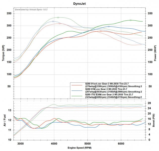

When it comes to 91/93 and you’re not tearing into the yeee old engine, we are stuck at 270-300whp depending on the situation going past this point is going to really require race gas or corn, or messing around with engine and at that point you better be on corn anyways lol
not only that but WHP is just a really mad metric to judge a car's speed by; if i drop a 300WHP engine in an F350 it might get stuck in my driveway. if i drop a 50WHP engine in a go kart i might be able to fly to France.
putting a 280WHP engine in a 2800lb car is a legit fast car. the real limiting factors are the tall center of gravity and the FWD. which an extra 70WHP is never gonna make up for unless you start hacking at the front fenders so you can fit 10in wide tires.
