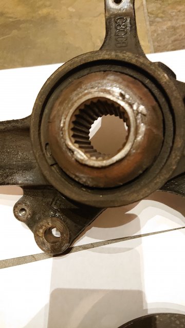

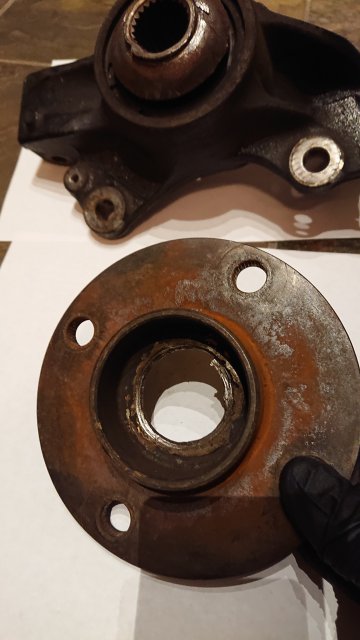

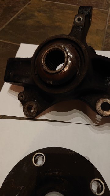

Pictures of the broken hub. Not entirely sure why the first one is so dark, but these are just from my phone.
The hub didn't separate while on my car. It was probably only cracked, so we thought it was somehow bent. I realized I had a big problem when the brake rotor started hitting the fixed caliper. The hub cracked all the way through while it was being cleaned to take home, and fully broke into two pieces while in the back of my car driving home from the track. Despite the splines no longer being perfectly round, the axle came out cleanly.
