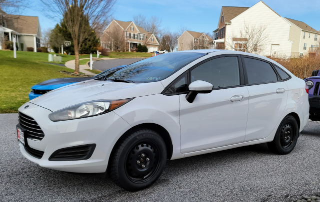

I would like to get this Fiesta riding better and making it more fun to drive, as much as a little Fiesta sedan can. Not trying to sell and get an ST or anything, just roll with what I have.
Highway speeds feels "twitchy" with what seems like a good amount of body roll. Feels like any sort of highway speed maneuver will result in the thing rolling over.
Not looking to AutoX the car or anything, it's my DD, but would love to make it feel more planted and less tiring to drive. Happy with the ride of a GTI and Camaro, so as far as measuring what "stiffness" I'm OK with, there is a data point for that.
I took the Kelly A/S tires off (hate these tires) and put Winters on my steel wheels.

I've kind of come to the conclusion that maybe Bilstein B6 with Swift Spec-R springs might be a good ride, but there's a lot of options. I wouldn't mind losing a little bit of my wheel gap but not looking to slam/scrape it either. Looking for a "set it and forget it" setup, not dealing with adjustables or coilovers etc.
Unsure if I'd be looking at B6 or B8...there is a lot of debate on here as it relates to ST, but not sure about non-ST since I imagine those springs would be lower than my factory springs?

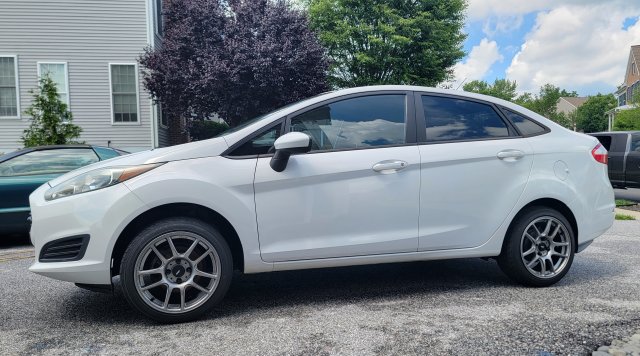

After putting these on, I definitely wouldn't mind a little bit of drop, something reasonable.
Sounds to me if I got the Swift Spec-R, the car would be sitting about where it is right now? I have a 3.5" gap up front.

I'm guessing here, but I think you would see around a 1-1.5" drop with swift springs. Just putting ST springs on a base model should lower a base model around 1" so I'm pretty sure the swift springs should be 1.5". If you're ok with waiting I will most likely be doing those in about 1-2 months after driving on the stickier tires. I think It'll be hard to beat handling of the swift springs for the price range, but if you just want to lower it. I think there are better options.
