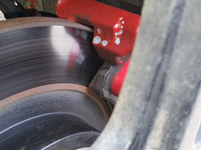

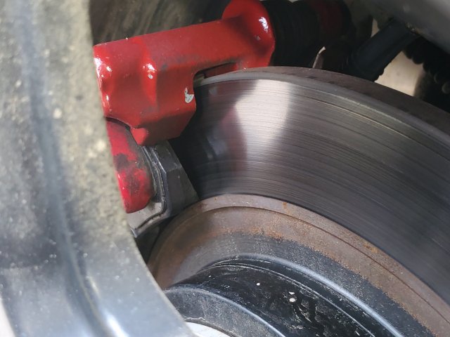

After cleaning off and installing a junkyard set of Focus SVT Caliper Brackets and installing new rotors and pads, I've been trying to figure out where exactly juttering in the steering wheel was coming from during brake application. It seems that it is not my unbalanced wheels but from the new brakes. A week after I bedded them I felt the jutter and assumed it needed another heat cycle so I did the bedding proccess again to no avail. Every once in a while I did some high speed stops on the highway but nothing helped. Recently I went to take a look at the brakes and saw extreme uneven padwear and a crazy amount of wear from trying to get them to bed evenly. Here are a couple pics, I'm ordering some new pads and I'm going to take them apart asap to try and find an issue.
Do you guys have any Ideas of what could be causing this?

Ideas — Make sure the pins are lubed and moving freely... and don’t run an overly aggressive pad.
I'm definitely going to check that as well and re-lube the pins, the brackets were heavily corroded and it is quite rough inside the sockets. Also could you explain why you think it could be because of an overly aggressive pad?

More aggressive pads can develop a shudder if brake parts and brackets have some flex, and with the whimpy floating caliper and longer bracket, I can see this being a possible cause.

Make certain the nubs that stick out of the back of the pads are seated within the gap of the X of the piston.
Yep that was the issue.
