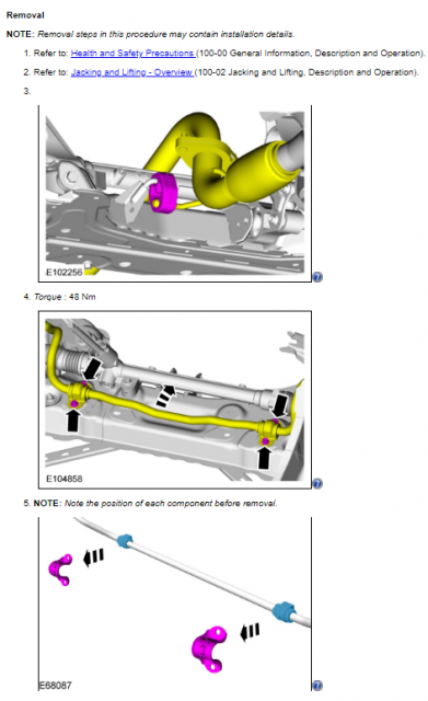

Is that manual highlighting the exhaust hanger to be removed?
Sent from my moto g(6) using Tapatalk
#10374
482
477
That would be the way it looks to me, probably just in case you may have to move it around a little. I know on my Focus I had to drop the subframe to get a bigger sway bar in.

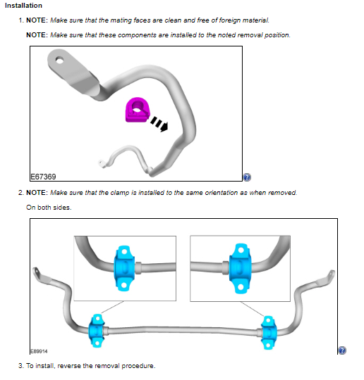

Ok I have successfully removed the oem bushings, now how in the hell can I manage to get the poly bushings onto the sway bar?! Anyone have any ideas? I did not lower the sub frame so I am working with very limited space.
Sent from my moto g power using Tapatalk
D
#3328
405
123
Thread Starter #12
The answer is boiling water. Yes, boiling water. Pop open the sway bar bushings with a wooden dowel and soak for 8-10 minutes in boiling water. This works for polyurethane bushings only AFAIK, worked like a charm. Made the bushing just pliable enough to walk essentially walk it off of the wooden dowel, little by little, whilst forcing the corner portion of the bushing onto the bar. A small gap is noticeable after doing this method but once you cinch up the bracket it doesn't even matter.

The shop manual shows it as being done without
The manual shows that you don't need to drop the subframe.
View attachment 25186 View attachment 25187
Thank you for the assistance
