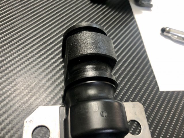

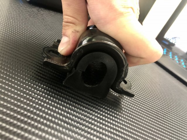

Hello everyone, I have the powerflex race front sway bar bushings and they don't seem to fit at all into the stock sway bar bushing mounts. Has anyone else with these bushings noticed this? Is this normal, I've had other cars with upgraded sway bar bushings and haven't run into these issues.

So I tried forcing them on for hours, the bushings fit fine on the sway bar, but there is just no way to get the mounts to sit properly, it's physically not possible. I am going to 3D model some new mounts and CNC machine them out of some extra 7075 aluminum bits I have around.

I got them to work. 80 grit sanding disc. Need to remove enough material to approximate factory shape. Needless to say not impressed with Powerflex. And given install difficulty you aren't going to want to go back in to re-grease when they get noisy. Just go with universal Energy or Prothane with grease fitting.
