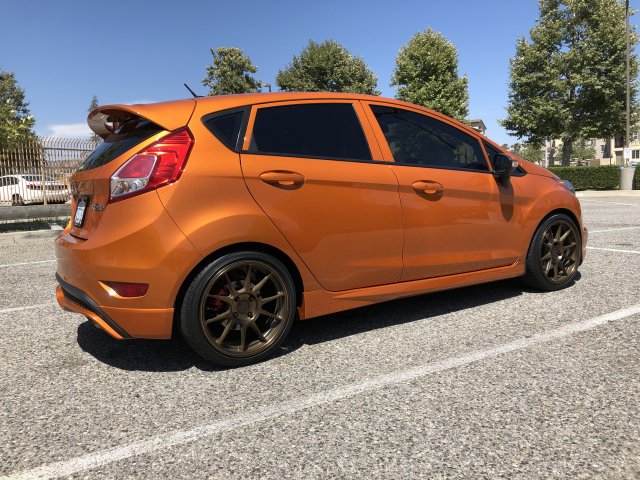

#13410
13
4
So I learned about Swift springs, read the how and why and was sold. They're for performance. They lower only as much as benefits a lower CG but without impacting suspension geometry. They only use linear spring rates so you always know your rate. No guessing from progressive rates. They dyno the stock dampers and match the spring rates to those.
I installed my springs at a friend's house on Friday and the improvement was felt immediately. The drop seems to be about 1" or maybe a hair more. I didn't measure because I didn't care.
On the road small bumps feel less bouncy. Body roll is almost completely gone (I do have a TB Performance rear torsion bar). Ultimate grip is way up and the car is now tail happy again. (It lost some of that with the stock springs and the addition of the TB Torsion bar).
This morning I had a great blast through twisty roads with a Cayman S, Mitsu Ralliart and 3 modified Focus STs. The car performed flawlessly. My custom (built by myself and Boostbumps) e20 tune was rock solid with +6 corrections all around and the suspension was on point.
I love it.
Photos:
I love the result, I recently installed the same springs on my fiesta st but it hardly lowered my car at all. They have been on for 2 weeks now, and dont get me wrong the performance feels amazing, right now I'm running the seifts with bilstien struts, and DNA racing bars for the front and rear, she handles like a dream! However the front only dropped like a quarter inch and the rear didnt drop at all. Did you have the same issue? Maybe the springs need some time to settle in?

#7801
1,051
787
The drop is subtle but you should definitely have a drop in the rear. I changed my rears out first and while it wasn't that noticeable to the eye, as soon as I sat in the driver's seat, it felt like it was tilted backwards.

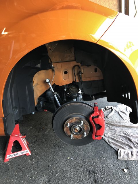

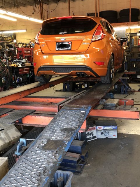

#11243
440
414
Got mine in over the weekend. Quite happy with the turn out. Not sure why I didn’t take any pics of the fronts installed. I didn’t measure yet to record the actual drop. I did take measurements before so I have the data to compare to. Then got it aligned this morning at Marlo’s Frame and Alignment. If SoCal peeps are near the San Fernando I highly recommend him. He’s a Ford guy and knows his stuff. His rack is all old school analog too.

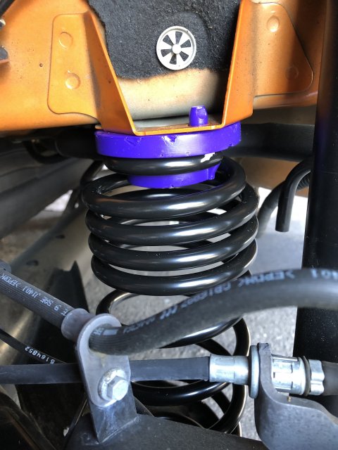

#11632
193
99
I love the result, I recently installed the same springs on my fiesta st but it hardly lowered my car at all.... right now I'm running the swifts with bilstein struts....the front only dropped like a quarter inch and the rear didnt drop at all.... Maybe the springs need some time to settle in?
Nope, it's the Bilsteins, pressure in these is high enough acts as gas "spring." I did the install with both stock struts and B8s. Stock gave the advertised level drop of 1 inch at both ends. Bilsteins lowered approx. half of that with the rear very slightly higher.
