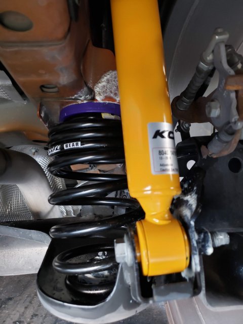

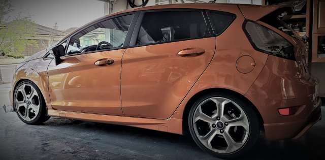

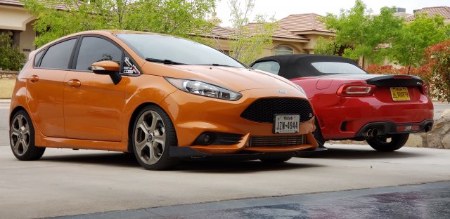

Hi, i wanna chime in with my 2 cents. I have the koni oranges front and yellows in the rear with swift springs . Main reason i went with oranges in the front is the price but i also wanted a softer front dampening for increased rotation which ended up working fairly well.. I have not tracked the car yet so I can't give any solid feedback on handling yet , but aggressive driving on the road indicates I have achieved my goal for more turn in without losing stability ( if anything feels more stable and solid). As far as the ride goes, the area i live in has horrible roads and constant road work and the setup has improved ride quality by ALOT! No more jiggly ride on the interstate and much more compliant in the city which came as a surprise. I have had a few other fiesta owners confirm and one was absolutely shocked he has yellow speed racing and has said it's MUCH better in ride quality. Other "handling" mods on the car are as follows , Powerflex street(purple) bushings in the rear , Pierce 2 point brace front , Pierce trunk brace . The yellows in the rear are not adjusted ( softest setting ) . My only complaint is the ride is fairly low now and since i haven't really had a really low car before, I'm not the most careful and has scraped the traction bar ( 2 point brace) a few times , which i'm super grateful for because a couple of them would have busted my cold side pipe or worse the oil pan ;/ The bar itself is holding up o.k but definitely has seen better days. I advise at least the 2 point with undeniable traction and handling benefits but also the protection for a lowered setup. I will track the car soon and can update on handling if anyone needs. Couple pics on how she sits..

Nice review... it does look like the ride height is a little lower in the front than my car with the stock shocks/swift springs.

Thanks! Probably, I can only fit 1 finger between the tire and fender horizontally. If I had the choice I would raise the car about an inch. But I wouldnt wanna give up the swifts <3 . I wanna upgrade to the ycw's if I ever get serious about tracking the car and move closer to a track ^.^ closest one is about 1.30 hours. =/
