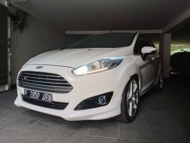

I purchased my switchback LED turn signals bulbs for the front at Diode Dynamics. You're going to need resistors which is an extra 10 bucks if you don't install the resistors you're going to have hyper flash if you like that kind of thing cool if you don't buy the resistors. They've been installed on my car for the past 3 or 4 months now with no problems. If you want pictures where I put the resistors let me know. If you just want to see my fiesta ST let me know 🙂

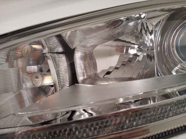

These are led. They are intended for switchback function. That means that they can be wired up for drl (always on when the car is on) and turn signal combo or used as parking light and turn signal combo depending on how you wire up the white light output. Basically if there is no turn signal then it will be white color and when there is turn signal the white will be off and the orange will be on until the turn signal is off then it will revert back to white color. The video might help.
