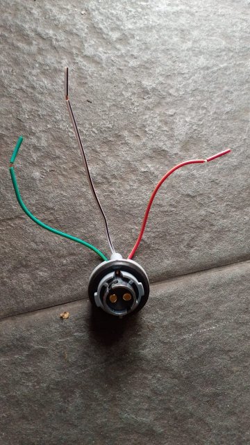

There are actually switchback bulbs that does not hyperflash and does not require any resistors. I've installed them on mine for the front turn signal and wired it so that the white comes on when the parking light is on and turns to amber when indicating a turn.You do need to change the socket for this to work properly.

Based on what i know, this has nothing to do with the car being USA or Europe model. What is most important is that you take a look at your bulb specs. If i am not mistaken the bulb type your turn signal uses will be either the BAU15s or BAY15s or PY21w. If that was the case, then get the BAY15d type.of bulb and socket (has 3 wires). Once you have those, all you need to do is trim off a little bit of the notches on the socket that you bought and make try and fit and trim off as necessary for a good tight fit. Then wire it up to the corresponding wires and it will work as you have imagined it to be. Remember, this means that the white part will only come on when you turn on the parking lights and is not a full DRL that is on all the time unless you wire it up to the fuse box for DRL function.
FYI - us in asia gets 4 doors only..... we envy the europeans!!!! We envy the other parts of the world where you all can buy the ST version. The highest level we have here is the 1.0L ecoboost with 125hp.
If you see the photo the white light is in the turn bulb position. So hopefully that is what you want.

The contacts on the bulb holder can be skipped and the car electronic sensor will not detect it as long as you connect a negative wire to the factory connector. This will fool the bcm to assume that there is still some load on the turn signal not from the factory bulb holder but directly from the connector. It is kind of hard to explain but perhaps the images below using an aftermarket bulb holder may help.
Basically get an after market bulb holder that has 3 wires (one + for the turn signal another + for the parking light and a negative and all should be tapped into the factory connector wiring). If you bought the proper bulbs, no need for any resistors or anything else, just insert into the bulb holder and guaranteed not to hyperflash. The only thing that is a little bit troublesome is to trim (not cut) or sand off some of the notches that stick out of the aftermarket bulb holder to ensure a good and tight fit.
