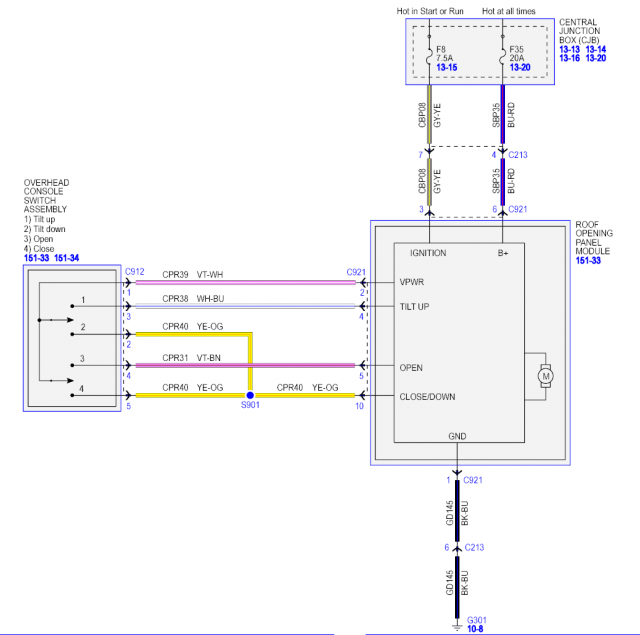

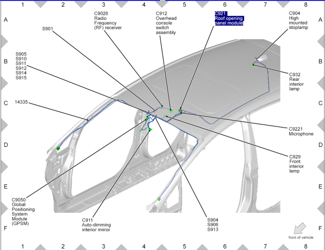

I am laughing at myself because I asked for a wiring diagram, got one, and have absolutely no idea how to read it. I'm assuming the black/blue wire, wherever, that is, is ground, and then anything coming off the switch itself is going to be switched 12v?
Agreed on using the sunroof power rather than map light, though I'm only doing auto-dimming rather than auto dimming with compass and temperature. Also agreed on the add-a-circuits, upon further inspection the boost gauge is tapped into the vehicle wiring and the dash cam is hard-wired without the use of an add-a-circuit using the included hard-wiring kit - that said, I do recall someone saying that there was an empty fuse slot in his interior fuse box labeled "auto-dimming mirror," I just don't want to run all those wires down the a-pillar if I don't have do. Feels neater, tidier, and more "factory" to tap into the map light housing.
4,282
2,810
It seems you know how to read it after all.
Grey/Yellow (positive) and Black/Blue (ground).
Violet/White feds power to the switch. The other wires are switched. But being post-module, there's a possibility that the power on those wires may be limited.
Cool, so basically, splice the switched power from the mirror into grey/yellow and the ground into black/blue and see if it works?

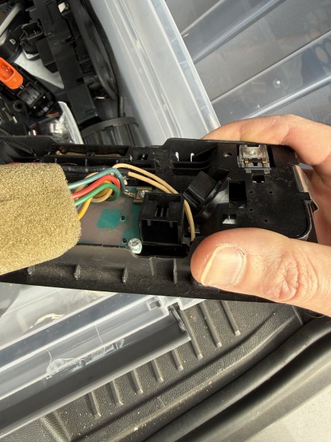

Well, I got lucky at the junkyard today and grabbed the auto-dimming mirror and the wiring pigtail out of a Fiesta Titanium for five whole dollars. It's got three wires - blue, green, and black - and they don't tap into any circuit up by the map light that I can see. You wouldn't happen to have a diagram of which of those wires is which, would ya? ;)

Okay, well, I finally got this installed PHYSICALLY with my new windshield, but my overhead console/sunroof switch does NOT have a green/yellow wire (+12v ignition) NOR a black/blue wire (ground)
Am I looking at the right switch @Intuit ?

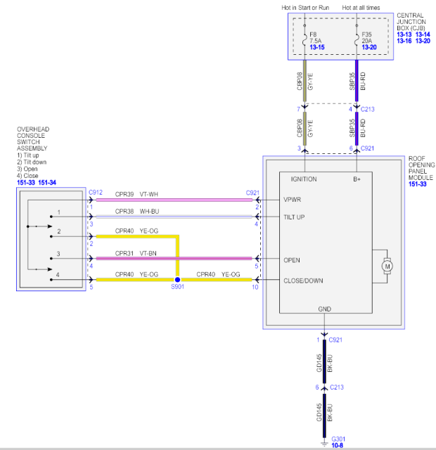

The wires to the switch could be low power. If the wires are tiny gauge, then it's a safe bet there isn't much current coming from that module and will need to tap the 7.5A or 20A power source for the module instead of the switch's power.
Roof opening panel module is located in C5 region...
If a backup cam is used...

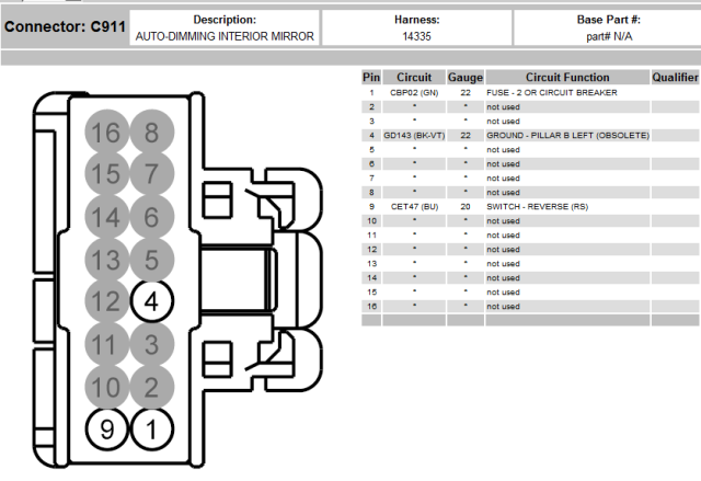

backup camera is wired into the factory harness. No dash cam. This is just an OEM mirror with three wires (C911 in your diagram): 12v ignition, ground, and (optional) 12v reverse, the latter being so that it won't dim when you're backing up but I don't care about that since I have the backup camera.
It appears that I am looking for a green-yellow wire somewhere around the sunroof switch (in the "roof opening module," specifically) for +12v ignition and a black-blue wire for ground, but that may be deeper into the headliner than I am willing to dig.

Ah... well, this is all it has on that....
Right, sorry, I'm just trying to figure out where those get plugged in on the other end. Like, that's the connector I have, I'm just trying to find the easiest place to splice those wires in on the other side without using an add-a-fuse or whatever.

In theory there's already a plug up there for it somewhere and I could just make the middle harness to plug it in there, but learning what I have about how Ford wired this car I wouldn't be surprised if there wasn't. I'd probably have to yank the entire headliner out to see, which I don't really want to do. Maybe next time there's a Titanium at the junkyard I can run over there and see what's up in the headliner.
Barring that, I may just run the wires down the headliner/pillars and into the body wiring harness somewhere else since ground, +12V ign, and +12V reverse should not, theoretically, be that hard to find. I was just hoping that somewhere up in the headliner there would be those wires easy to access, but it doesn't appear that Ford wants to include that information in the wiring diagrams.
EDIT: oh, duh. There it is. Right there in your diagram in Posts 5 and 13. Mirror (C911) plugs into the Roof Opening Panel Module (C921) which is between the switch and the sunroof, and that has both +12V ign and ground, though no +12v reverse (which is whatever). I'll see if that is easy to locate with the map light assembly out. If not I will think about how committed to his bit I am.
EDIT 2: okay, in the whole headliner, Yellow-Green is +12V ignition, Black-purple is ground, and blue appears to be +12V reverse throughout the entire car. I can figure this out.
