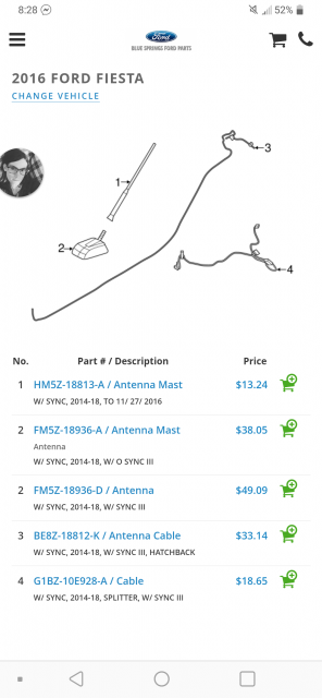

#10374
482
477
#29
You think it might be possible that #3 in the picture could have worked loose? Other than that it might end up being a faulty Nav system. 😐

Thread Starter #30
There was only two connectors on my antenna.... Same as the orignal unit. And my sirius/ amFm work. Unless that third part is buried in the antenna base... Fords part diagrams arent the greatest to go off of. And ive yet to find a pic showing the location of the gps antenna portion

Thread Starter #31
Whats the part name for #3. I cant find that anywhere on tasca Ford's page.

#32
I'm not sure, I just googled the base number and looked for diagrams and came up with the 1 that I posted.

#34
See if you can copy and paste what I have in the search bar and you might be able to find that part. I'm on my phone and can't search very well.

Thread Starter #35
Screenshot_2019-05-10-20-28-07.png thats what i got searching the same thing.. Crazy.... Lol.
