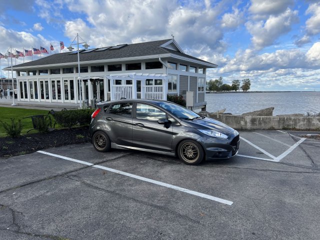

I am not totally in love with the looks of the Enkeis, but I still prefer them (even aesthetically) over the factory stocker 'boat anchors'. [thumb]
The RPF1's weight or strength to weight certainly CANNOT be argued against, at all, regardless of what one thinks about the looks. [wink]
