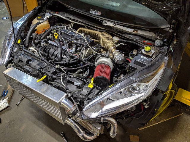

Hey Guys,
Have not been on the forums for a while so here is a bit of a build thread, any questions ask away, so far i have like 10000 miles on the setup no issues just smiles

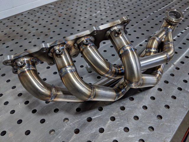

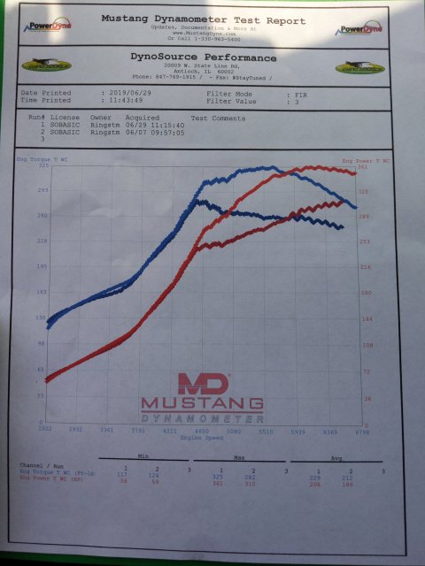

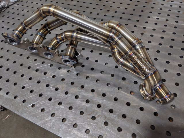

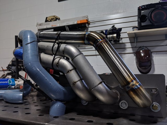

What gains would you guess you’re getting over a ported exhaust manifold?

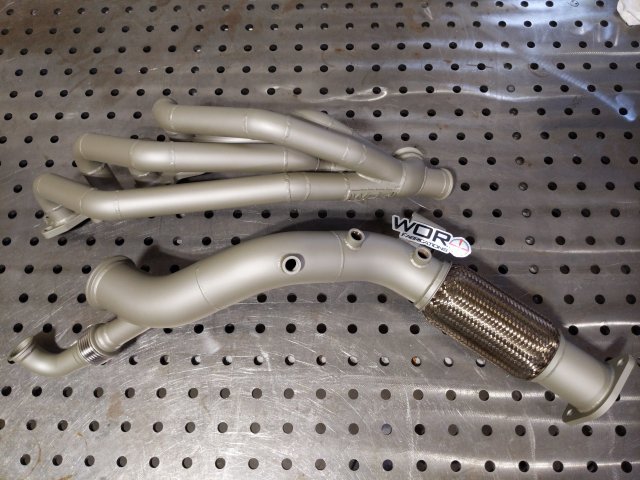

How much was this little fiasco? ...That is all I wanna know! some very nice Fab work...ill bet it wasn't cheap! But worth it! [loveboost]

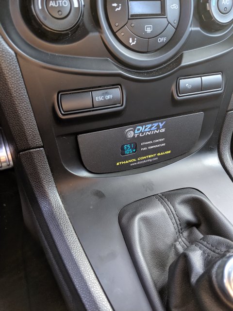

How do you like the Dizzy Ethanol gauge?
works as it should, super easy install too
yeah wasn't cheap but the results have made it all worth it
no clue, there are pluses and negatives to both setups for what i want and do with the car it performs perfectly, I really need to get it back on the dyno now that I have a better clutch and go for more power.

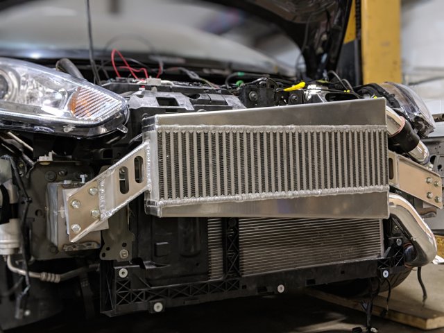

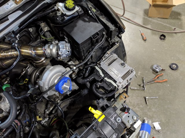

Nice build. The other day I was thinking about why nobody has done a forward facing turbo setup like your's. I figured the fitment would be tight and it sure looks like it is. What are you doing as far as the MAF goes?
MAF only reads IAT on US model cars so i wired in a focus IAT sensor and stuck it in the end of the filter not the cleanest but better than the huge MAF
