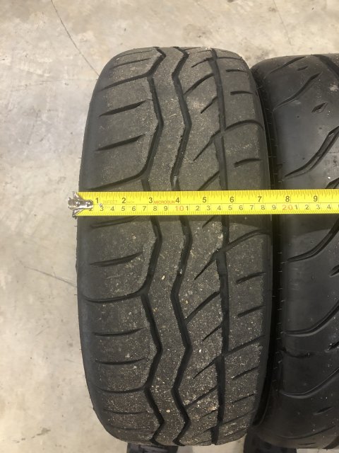

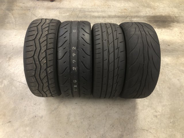

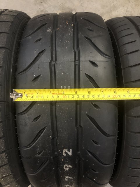

They're great and grip really well, but they need heat. I can't recommend them for street, although my buddy that bought them from me raved about them. He's an AutoX and mountain run guy with a MRX. He doesnt have anywhere near the torque we have. They'll spin when cold.
They're right at 8" wide and likely close to your RSR. I posted a pic of the RT615K+, RT660, RS Pro and Indy 500 side by side somewhere. I'll see if I can find it.. I just wasn't a fan of the softer sidewall and buzzy noise. I think the flexy soft issues I experienced were totally my fault for not running high enough air pressures. The buzz isn't RSRR bad, but I'm sensitive to noises and it bothered me. In my opinion, the RSR is better suited for street because it doesn't need a lot heat to grip. The RT615K+ is the same. It always has grip, but it is narrow when compared to most of today's 215s.
Thanks for the info and pics. I value your opinion since we have a similar setup and you've tried out so many tires. The RS Pro is about the same section width as the RS-R so it would look about the same on my rims. However they have .5" more tread width which is significant. But based on your review they don't do well in cold temps so it doesn't sound like a good all season tire for street use. I've used the RS-Rs exclusively year-round here in Georgia and have had zero issues in cold weather.
I added the RS Pro to my data, below, for comparison.
TIRE - PRICE - WEIGHT - SECTION WIDTH - TREAD WIDTH
Federal 595RSR - $103 - 22lb - 8.7" - 7.5"
Federal RS Pro - $113 - 21.8lb - 8.6" - 8.0"
Nitto Neo Geo - $105 - 20.9lb - 8.86" - ??
Falken Azenis RT660 - $150 - 22lb - 8.7" - 7.9"
Dunlop Direzza ZIII - $164 - 20lb - 8.1" - 7.8"
Falken RTK 615+ - $115 - 20lb - 8.7" - 7.2"
Kumho Ecsta PS31 - $88 - 19lb - 8.6" - 7.2"

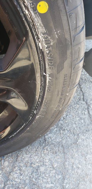

Im on my second set of indy 500s. For the price best tires so far, grip is good, decent in the rain
I see your installation place uses that 'animal fat/lard' bead lube as well. [mad]
I am trying to find a local place that does NOT use it, and just uses soap or something else less staining/tenacious, since I will NEVER be able to get that crap off of my satin black Dekas once I mount the A052s on them. [:(]
Never heard of animal fat being used as a tire lube, most shops buy some sort of white goop that is roughly the consistency of soap.
