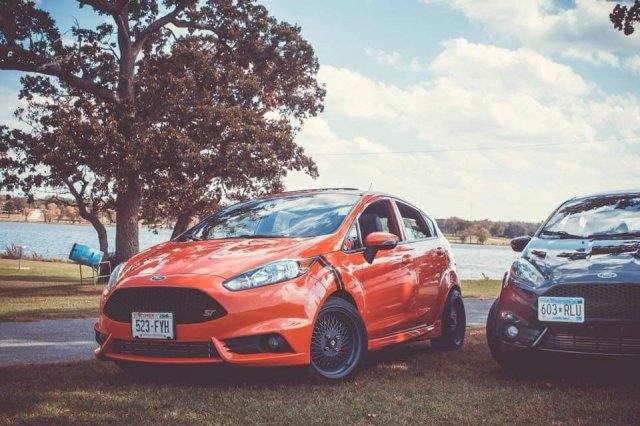

My car on 16x7 et20 wheels, when it was on stock suspension. Also had a 5mm spacer on the rear wheels. Tires were a 205 45 iirc. No longer have this setup. Only barely rubbed the rear on full compression with a loaded trunk.
:coffee:
EDIT. I should also note that the backspacing on these wheels didnt clear my front caliper brackets. So i shaved the bracket by about 1/8". Otherwise id have had to run a spacer up front. FB_IMG_1577075480774.jpg
:coffee:
EDIT. I should also note that the backspacing on these wheels didnt clear my front caliper brackets. So i shaved the bracket by about 1/8". Otherwise id have had to run a spacer up front. View attachment 26353
That looks amazing and I cannot imagine how hard it was to keep those wheels clean.

Actually really easy, lol. They were dipped grey. I do want another set of something small like this again.
That's crazy. I put the 'red stuff' pads on and still have to clean them every few days. Maybe it's just the shape of my wheels that pulls all the crud to the cups.
