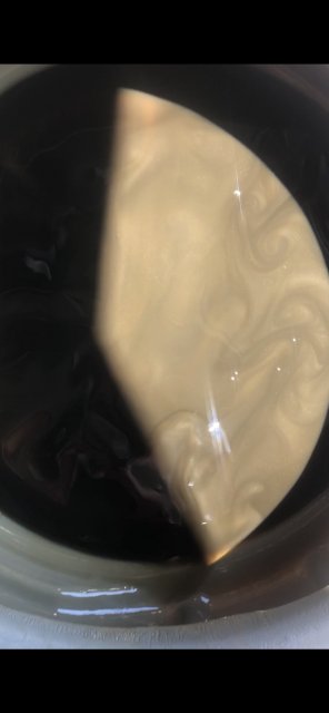

Did another drain and fill with ravenol and a magnetic drain plug. No metal chunks but this is what came out.

Looks very much like my oil when it came out before swapping out the transmission. I don't know if it has to do with normal ware or not but that fluid is super clear when it goes in.
