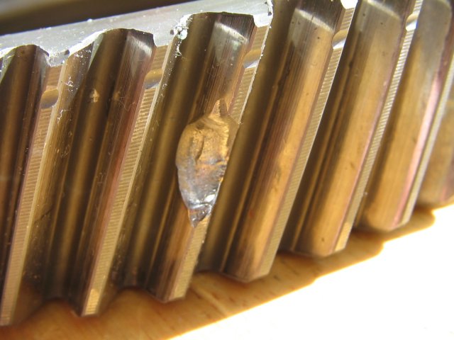

Final drive gear. I cannot be sure of the exact type of fracture here and the cause.

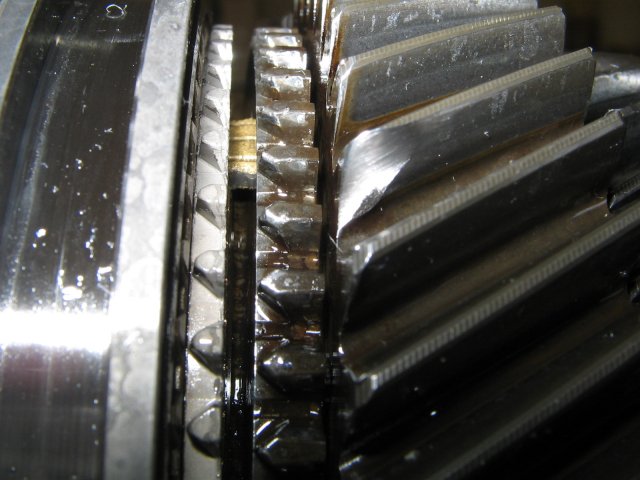

4th gear, countershaft. Brittle fracture caused by impact damage from the chunk spat out from the final drive gear.
There is also damage to 2nd gear, countershaft. One tooth is deformed on its edge. I cannot be sure of when this happened and if it is related to main failure.

Might have been a flaw in the material that just let go.
Yes it could a flaw in the material which are called Inclusions. It looks like the fracture started in the middle of the tooth and went out wards. The last part of the fracture on the edge of the tooth is "Brittle" to look at like 4th gear.
