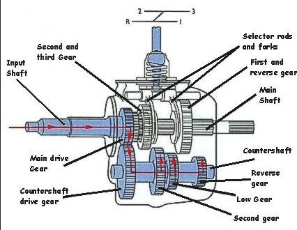

Not seen it mentioned, but fill with 2 liters when you replace the fluid. I have heard the manual specs something like 1.69qts. The problem is that is not quite enough to reach the bearing on the input shaft. No data to back this up, but can't hurt!

One of the members pointed out that the difference between 1.6L and 2.0L, was in the switch between metric and standard forms of measurements. The manual specifies both, 1" from the hole -and- 20mm below fill hole. 20mm is 0.79". 0.8" is 80% of 1.0". 1.6L is 80% of 2.0L. No reports of negative affects from either fill capacity though.
