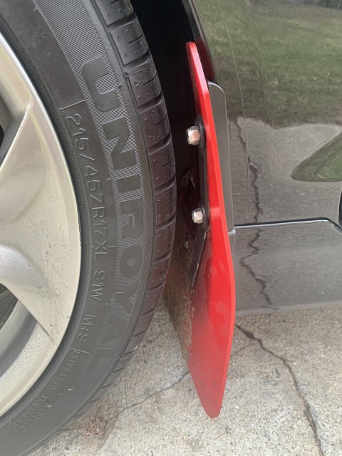

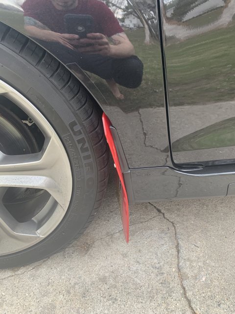

So I have these rally armor mud flaps that IMO fit horribly in the front because of those plastic trim pieces. The bolts that secure the flaps are awfully close to my wheel setup as well. I will need that space for diff wheels later.
so I suppose I’m here asking if anyone has found a way to make these mudflaps much better fitted similar to how the rear seats it’s self.
I haven’t taken it all apart yet, trying to not deal with that yet I case anyone has some suggestions. See pictures below

Since I may end up with even LESS clearance to those bolts with the wheel/tire setup I want to get soon (some 16x8 wheel with 225/45-16 Yok A052s), than you have there, I was going to try and find some FLAT lock nuts to install there, and then grind down those 2 studs to be flush with them when fully tightened.
Then I have to take off the HUGE SMS flaps I have attached to the Rally Armor mounting hardware and trim them down radically, since they are rubbing on the 205/50-16 Neo Gens on 16x8 Dekas, even at factory ride height/on factory suspension. [:(]

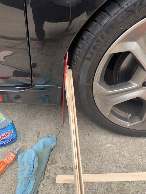

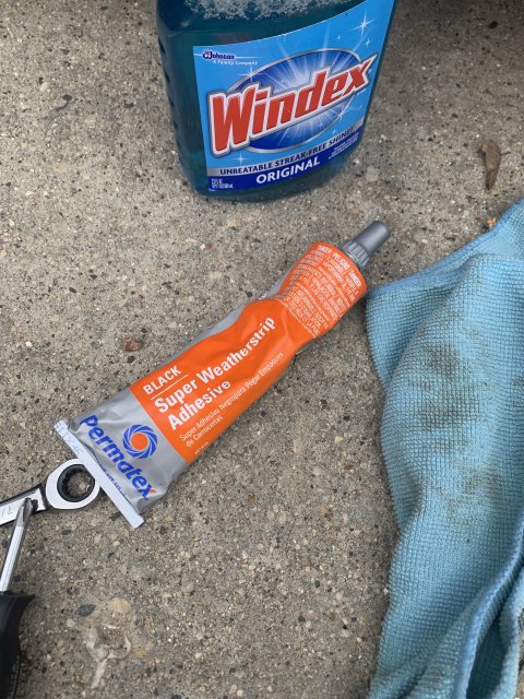

I checked holes and stuff everything seemed to be fine. It’s just that the plastic is too ridged to take the wheel well curve. Just used some black high strength trim glue and some shims.... see if it holds up. Glue is flexible and hold tightly is goal.
I will be grinding gown studs and using shallower nuts as well, great idea M Sport

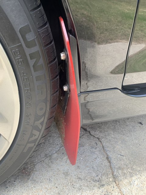

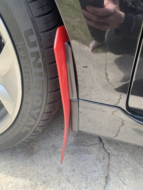

regardless, I popped in to show some pics of the flaps glued with the weatherstripping adhesive. Worked REALLY well! Can’t say how it will hold up, but it feels really solid. Here’s the pics:

REPAIR UPDATE:
It’s holding up WONDERFULLY.... car washes and plenty of driving. Holding together nice and strong! I would recommend this “repair” if anyone is experiencing the same issues.
Have yet to use slimmer nuts, but we all know what will work just fine per described above (grinding bolt down etc)
