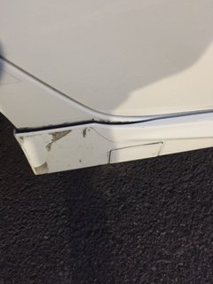

I have similarly poor fitment. I bought this car new last June and installed the flaps in July. I have recently noticed this is causing paint to chip on both sides. I followed all the instructions very closely while installing these so I'm not sure what the reason for this is. Looks like they will be coming off very soon. Not to mention, one of my $40 pieces of rubber has begun to tear.

Ended up removing the top plastic piece for the time being and it appears to be sitting quite a bit more flush. I'll see how this holds up for the next few weeks. Also noticed the paint is not chipping, it's just the protective film that is peeling up so that's a sigh of relief!

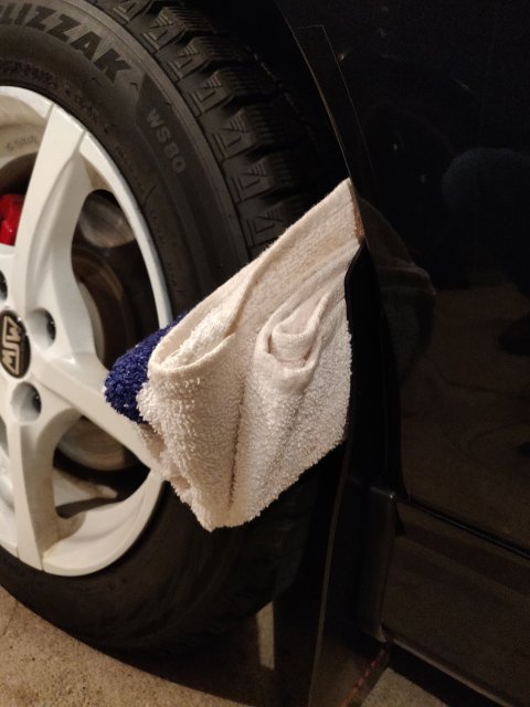

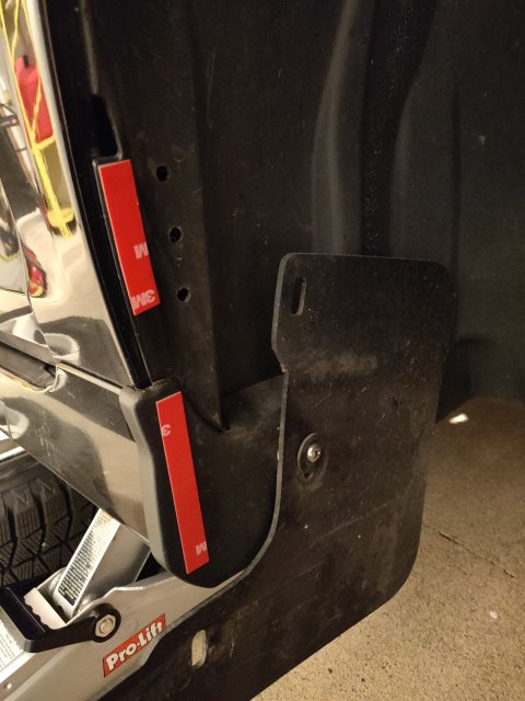

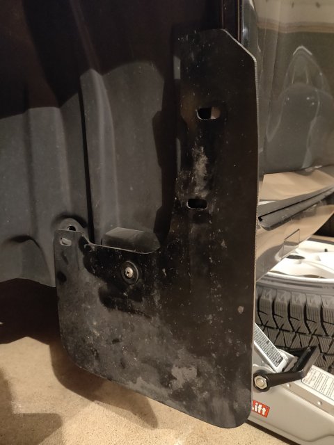

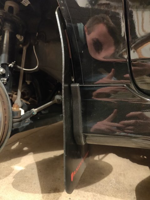

Hey guys,
So I got frustrated with my mud flap fitment again last week so I pulled off the inner and outer brackets for both front mud flaps. I retained the middle screw and replaced the outer brackets with some 3M molding tape from Advance.
https://shop.advanceautoparts.com/p/3m-super-strength-molding-tape-1-2-x-15-ft-03614/7100055-P
This fix has held up well through one heavy snowfall and a carwash. I will update if that changes. I think it looks pretty good, though I might get some foam tape in the spring to fill the gap above the side skirt end cap.
One note: I stuffed towels in the wheel wells for 12 hrs after applying the tape to help it properly adhere.
