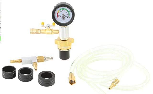

Bought this...
https://www.amazon.com/gp/product/B01BW39HJS/
...pissed away half a weekend fooling with the defective Venturi adapter.
Bought an actual vacuum pump and still had issues.
Wouldn't hold pressure or vacuum.
Found the source of the issue...

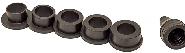

The silicon/rubber adapters that came with my tool appear to be slightly different from the one in your photo.
They have a lip that prevents them from inserting too deeply or falling into the tank. The cone is simply too small to seal.

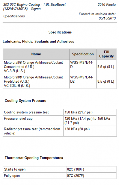

Attached PDF documents for the drain/refill procedure and description for the operation of the cooling system.
"2016 Ford Fiesta ST - Cooling System Operation Component Description.pdf"
"2016 Ford Fiesta ST - Cooling System Drain Vacuum Refill.pdf"
