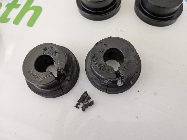

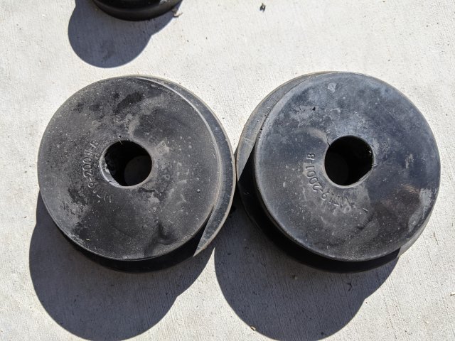

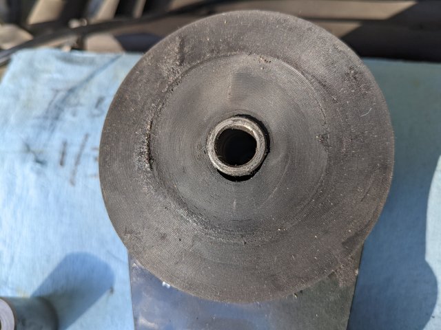

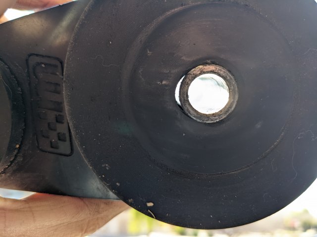

Whoosh RMM bushings after ~16k miles
Polyurethane bushings deformed, I assume due to heat since they are mostly intact but no longer hold themselves snuggly into the mount frame or hold on to the little spacers/sleeves that go through the mount. In the video you can see the rear sleeve is missing (I hadn't realized it had already fallen out while removing it from under the car) and you can see the bore in the front bushing is sorta oval shaped now. All of this ended up introducing play into the mount which made the car a lot more numb to drive and difficult to drive smoothly.

I can definitely see that being a problem.
