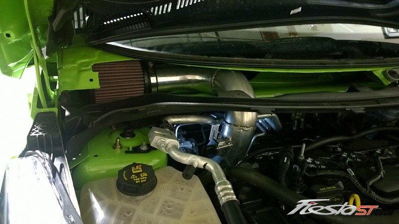

I got the ITG crossover installed and I can confirm that it does reach all the way to the inlet elbow [emoji1303]
I had to get a new 70mm elbow since I already modified the one that came with the kit.
I trimmed about 2" off the elbow on the turbo inlet side
I also trimmed an area on the bottom of the elbow to clear the Turbosmart Plumb Back
The replacement elbow was a little thicker than the original
The included bracket for the ITG crossover didn't really fit anywhere but I was able to use it by adding a grommet to the bracket and some plastic spacers.
Comparison pic, this one is on the UK version
From the front. Also, the breather hose connected with no issues

This itg crossover pipe expecially made for this hybrid or just off the shelf that fits any fiesta with oem turbo ? If the later, what makes it so different from, lets say the ramair? Thanks
VirtualRonin
VirtualRonin
Military Veteran
565
460
Ajo, AZ
Thread Starter #92
The description in this link says "Fits all global 2013 and newer Ford Fiesta ST 1.6T"
https://clptuning.co.uk/product/itg-maxogen-pro-cais-crossover-intake-pipe-ford-fiesta-st-1-6t/
I purchased this because the company that makes this turbo, AET Motorsports, recommends this crossover pipe specifically and since my RamAir wasn't a direct fit I wanted to see if this one would fit better.
Here's some comparison photos. You can see the ITG is a little different but it pairs well with the VT330R turbo.

it's easy to see the difference
the RAMAIR has a bracket that will not allow for any adjustment from the OEM location of the crossover pipe
the ITG is held in place with a half circle bracket with a rubber strap (same as the ITG intake kit mounting we have on the shop car) This is much more forgiving than the OEM crossover pipe or the RAMAIR which fits like the OEM / solid in place
