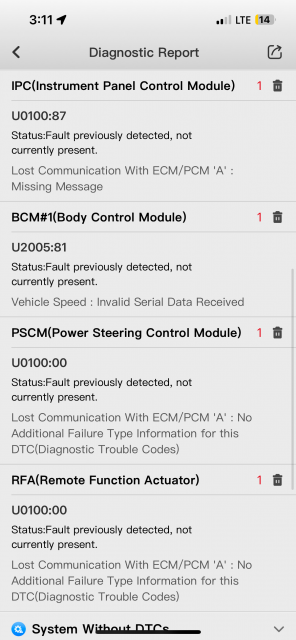

been having issues with steering or maintaining a lane. like alignment was off. but found some stored codes but never had any cel/ lights on dash.
anyone familiar or know why these could be coming up

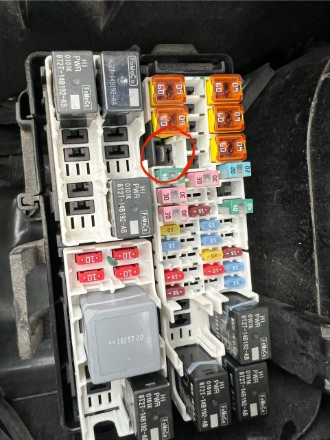

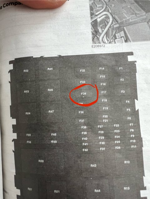

all my fuses checkout.. checked codes again and the previous codes are gone?! wtf another thing is I found a fuse missing? is this fuse suppose to be here? anyone missing the same fuse? 2019 FiST!!
C
23
las vegas
disregard.. not suppose to be there per dealer.
