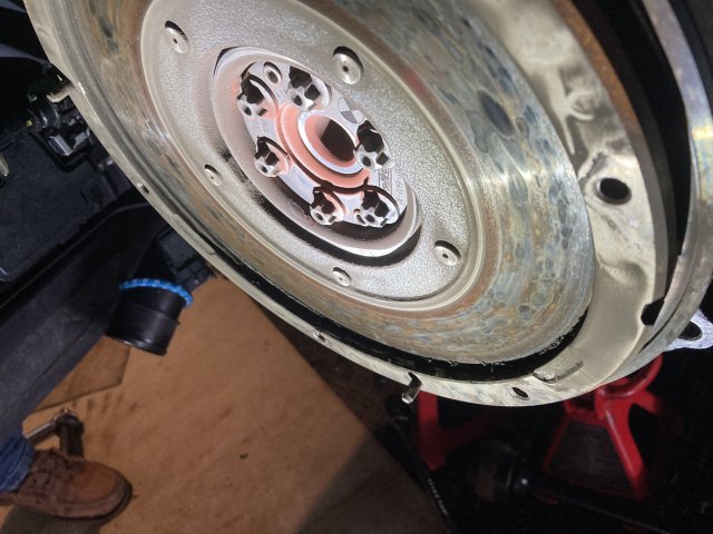

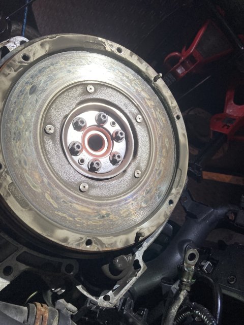

Welp didn’t plan on a flywheel when doing the slave

Yikes...
Just more touchy pulling away from a stop, needs more throttle and maybe a little slower engagement. After moving, not really a huge difference unless you are on the gas and blipping for downshifts, etc. Also more noise, chatter at idle, etc.

Ive been asking how a SM is marketed - as AtlantaM3 implies - its touchy as hell and and incline stop sign is awe-inspiring. What exactly are the 'features and benefits' going Single Mass?

I’ve barely noticed a difference going to a single mass RTS flywheel. It’s not a light weight flywheel, just single mass. Light weight seems to be where concerns arise
