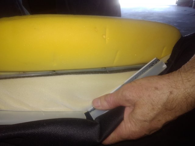

My biggest regret is I have the shitty base cloth seats .. so I'm looking at options and wondering what other people are running ? How's fitment and all that ..
You might want to give some serious consideration to having a stock Fiesta seat lower cushion "rebuilt" with better medical grade foam that is recontoured and covered in either similar cloth or maybe a grippier type of material? I was told that it would be about $425 bucks depending on the material, by a very reputable custom automotive upholstery shop. I have Recaro seats, but I knew what the base seats were. I am a skinny man. The base seat is most lacking in side bolstering and thigh support. Both problems could be addressed with a lower cushion rebuild.

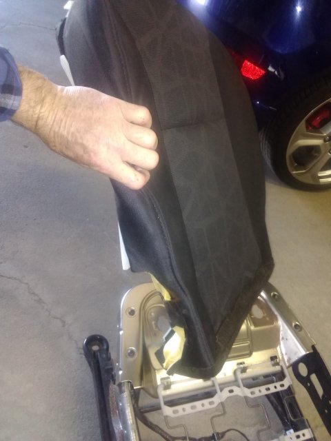

#19
I pulled out a driver's seat base with the cover and cushion removed to illustrate the ease of getting It apart. Even the forward seat cushion support pan is removable by taking out four screws. The cushion is separated from the cover by removing the hog rings. From there on it's a matter of deciding on what you want to do with the bolstering and pad length. In no way is it like rocket science.
