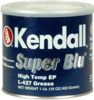

Experiences with prior vehicle: Sometimes grease alone isn't enough. The problem is just too temporary and you're back needing to do the same thing in a year or less. The bore narrows and you have to hone it out a bit. Use steel-wire pipe cleaner brush attached to a high-speed A/C drill. The pins can be sanded using the same rotating brush. Before I developed that permanent solution, the best, longest lasting results seemed to come with Kendall's High Temp Super Blu L-427 Bearing Grease. (note: bad for rubber, might not affect silicon)
