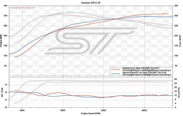

Here is a direct comparison of my max effort 29psi whoosh setup on aux fuel vs my buddies s280 build with a tubular manifold and full fuel system. On 93 it’s kinda of a wash but on corn he got me beat by alot
Blue line is whoosh
That graph is 93 or E30?
Blue line is whoosh
His pull starts later than yours he needs to go back and do another pull starting at 2500 rpm for it to be an accurate comparison otherwise its just not and its useless data.

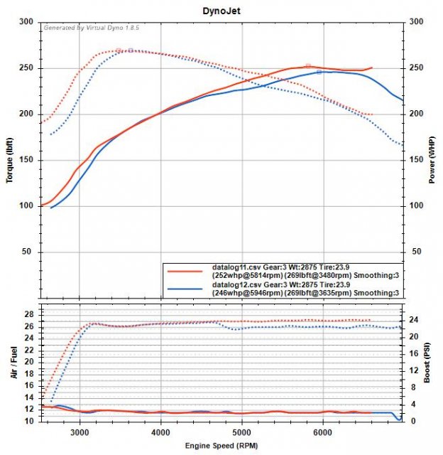

I think I got the VDyno dialed in better, trimmed out that spike at the end there where redline limiter dumps. Someone told me what smoothing was best but I forgot already. Scratching my head trying to think what I might of did on the blue pull to have it fall off a little. I want to try and find out what a more accurate wheel diameter is for my set up 215/40/17 Dunlop Direzza ZIII
*edit-found the Direzza info on Tire rack

Final revision. I looked up the curb weight of the 2019 and weighed myself, adjusted the wheel diameter to match. I am liking it. Thought torque would be higher BUT E30 is about to begin and I will get some torque there :whistle:
