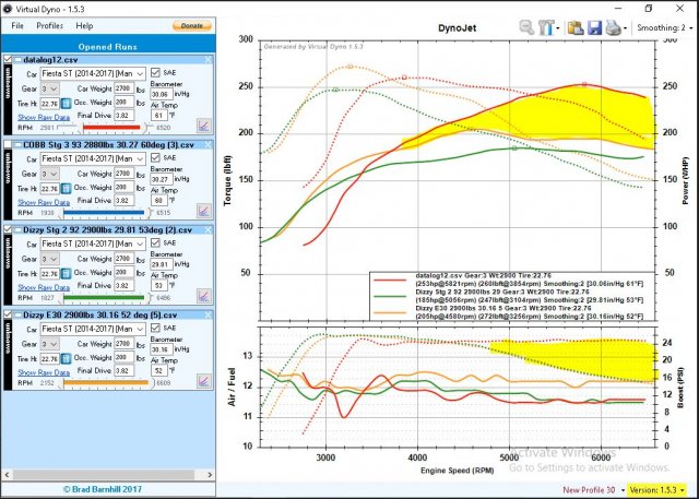

I just got my final tune revision with my Whoosh hybrid turbo. I took it for a couple back to back runs on a fairly flat road this morning. Here are my virtual dyno curves. I didn't weigh my car today, but I have in the past, and I think all the factors for the virtual dyno are pretty correct, so I left it with level 2 smoothing to show the peak torque hit around 3500 rpm, I think I was getting peak around 3000 rpm on the stock turbo, but I was doing these pulls starting at 2500 rpm. I suppose if I started a little earlier in the rev range that peak torque might also happen earlier. I highlighted what I think is the most important difference between my E30 tune and this one, mainly the HP curve just keeps going. I'm very happy with the results. Now to get tuned with E30 on the hybrid, and get my LSD installed next week.

Link/ picture no worky

Add your weight to the vehicle weight * then change it to smoothing 3 to see what happens.

What is your elevation?
