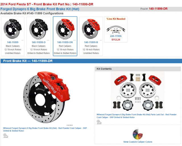

Can anyone explain to these wheel clearance guides?
Wilwood Forged Dynapro 6 Big Brake Front Brake Kit (what's on whoosh)
vs
Forged Dynalite Big Brake Front Brake Kit
the top is the 6 piston BBK that you can find on the whoosh site. however most everyone has wheel clearance issues with that build. the bottom is a the 4 piston kit that Wilwood markets/fits to 90s era Civics/Integras. The eye test says the 4 piston would have better wheel clearance but it seems like on the sheets provided that's not the case? if anyone could better explain the above clearance guides I'd really appreciate it. I've already reached out to Wilwood to see if they could make the Forged Dynalite fit the Fiesta. Has anyone else talked about this before? What little I could find on the forum didn't really mention much about people going this route.

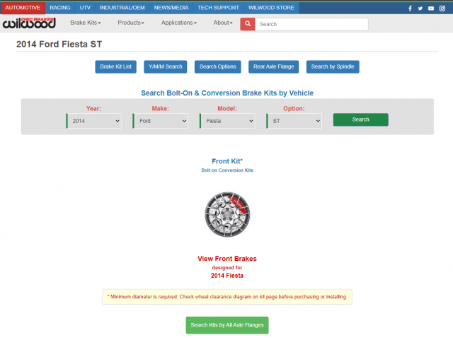

It would probably help if you knew that Wilwood doesn't make a brake kit for the Fiesta ST
The front and rear options are Base model kits, designed before an ST was available so any clearance questions you have related to the ST and it's wheels won't make sense

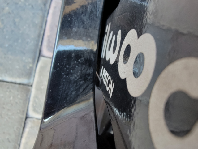

I installed the Wilwood brakes that Whoosh sells and if you are wondering what wheels they will fit. I used my OEM alloys and they fit.
You did front and rears? With Stock wheels and no spacers? And they fit with with no rubbing?

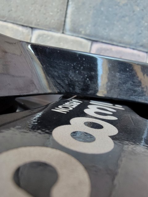

I had clearance from the spokes to the caliper, but it was really close. I used a 3mm spacer for peace of mind, in the front. The rears were using the Focus SVT brackets and rotors. No spacers were needed in the rear.

Maybe not designed for the Fiesta ST, but they've certainly started marketing it for the Fiesta ST
From their website:

It works with OEM wheels without spacers, but barely. I ran it like this for about two months without issues until I swapped to Konig Hypergrams, which has plenty of clearance.

That's scary close! Hub centric 3mm spacer isn't gonna do any harm but a bad pothole just might

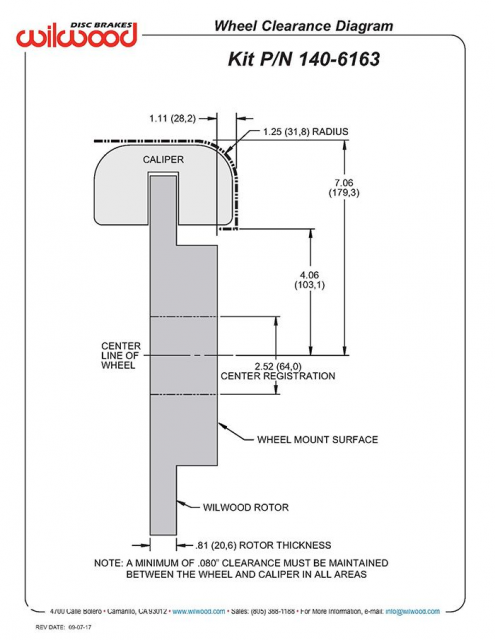

okay, there seems to be some confusion here so i'm going to be as clear as I can be so everyone's on the same page:
1) the whole point of this thread was me asking if someone could explain the wheel clearance diagrams. specifically the difference in caliper width between the Wilwood 140-11899 caliper and the 140-6163 caliper. *BOTH ARE FRONT DISC BIG BRAKE KITS FOR ABS SYSTEMS*
2) no one, not a single person, gave me an explanation of the wheel clearance diagrams (which is fine; still learned some stuff so thank you)
3) i *never* mentioned anything about a rear brake kit. Maybe someone else did in passing, but that's not the focus here.
4) i simply want to know if the posted wheel clearance diagrams definitively state that the 140-6163 caliper (the 4 piston) actually sticks out farther from the wheel mount surface than the 140-11899 caliper (the 6 piston)

Looking at the diagrams, the rotor width is equal but the .91 of the 6 pot vs the 1.11 for the 4 pot says to me that the caliper is a tad wider and would contact the wheel.
The height is .03 lower for the 4 pot but that only makes matters worse.
Nothing a 3mm spacer couldn't correct.
Checked Summit Racing for pricing on the 4 pot and according to them, it won't fit.
https://www.summitracing.com/parts/wil-140-6163
thanks for checking. wilwood customer service never got back to me. either way, if the caliper actually does stick out farther that negates the biggest reason i was thinking of trying this out. it's just interesting as the 4 pot is marketed to FWD mid90s cars with much tighter clearances (or so i thought)
