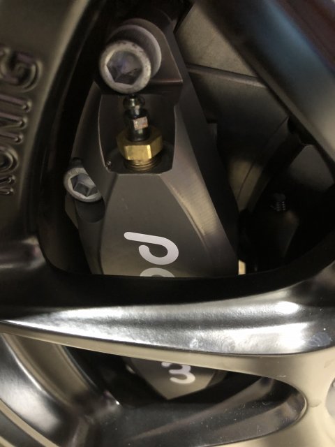

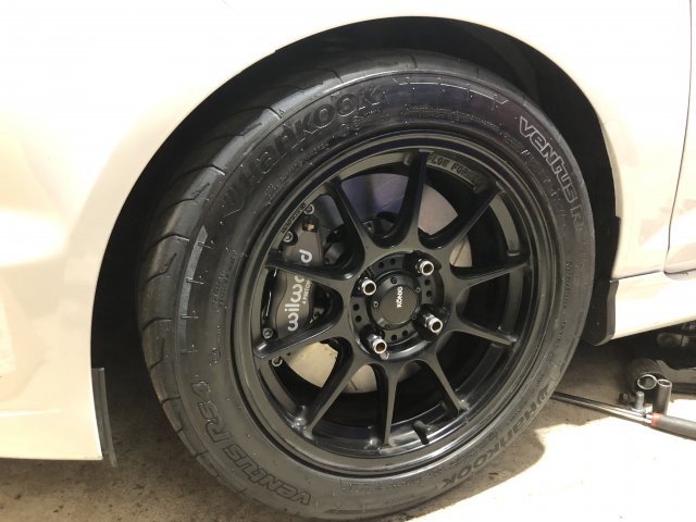

The TCE Performance kit would be damn close on the stock 17x7 wheel without a spacer seeing the space between my caliper and the Dekagram. I dont have stock wheels to test though. If anyone wants to come by and throw a wheel on real quick we can test it out.
This TCE kit is 4 piston radial mount DSP calipers, 11.75" GT rotors, TCE brackets/lines and hardware kit.

Kit is not listed. Only his most popular kits are on the website. Found out about it from another member who used it on a rally build to fit under Method 15" wheels.
Kit components:
Wilwood 4 piston DSP radial mount calipers
11.75" x .810 GT Casting(Spec 37) w/ Wilwood dynalite hats/rotor rings
TCE brackets for 11.75" rotors
TCE/Wilwood brake line kit
Wilwood BP30 pads
Wilwood hardware kit
